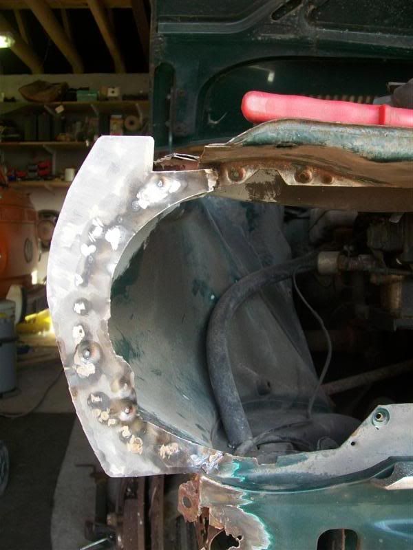

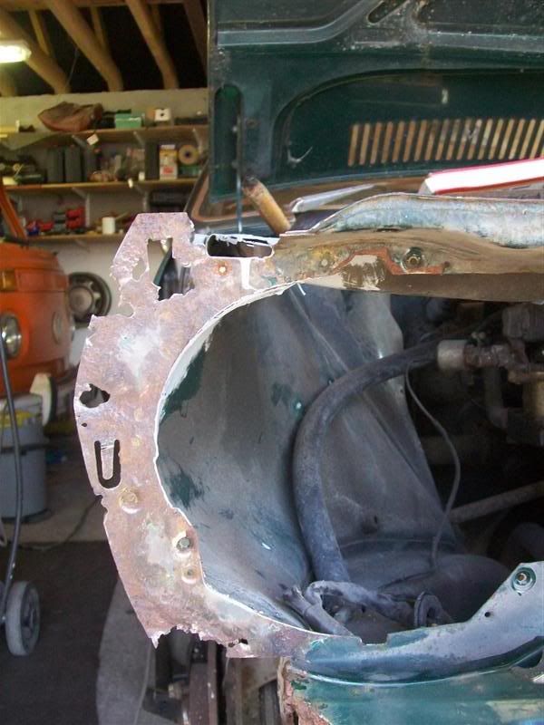

So I set-to with the repair work, starting with the front right wing. It took a bit of work to get it off but once off I discovered a small bit of rot in the inner wing and strengthening panel. I've been working on that corner since, it's almost finished. The other inner wing is in similar shape and will need the same repairs.
Since this area will never be seen again I'm happy to do strong welds but not bother too much with original appearance. So long as it's all good steel under there and well undersealed it'll be good as new. It won't win me any concourse prizes but I know it's all good

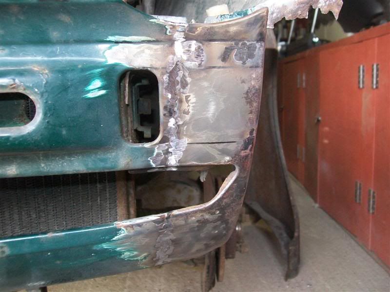

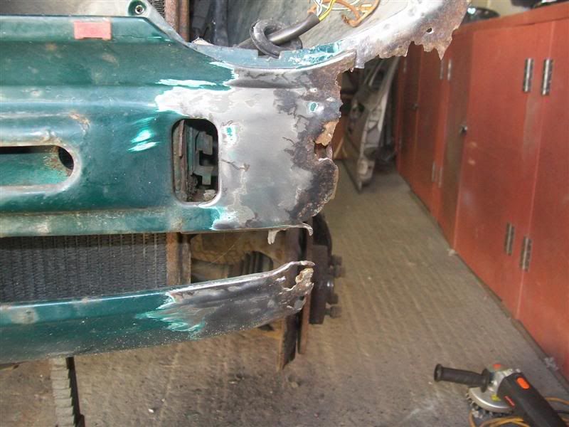

front valance edges:
same on the other side
