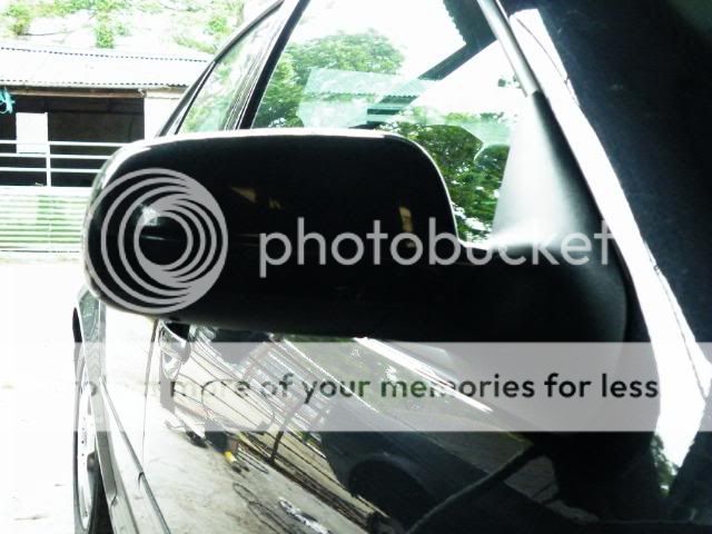

it a mod that i wanted to doo for a long time but could never get the stubby F******.eventually i got 2 from a 01 seat arosa with manual adjustment.
before i started
excuse the shit quality pics.

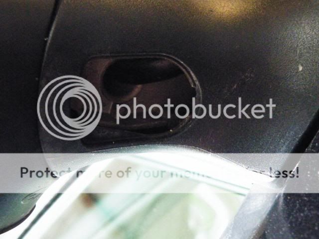

pop out the little gromit on the bottom of the mirror,and stick in a small screwdriver to pop off the top cover

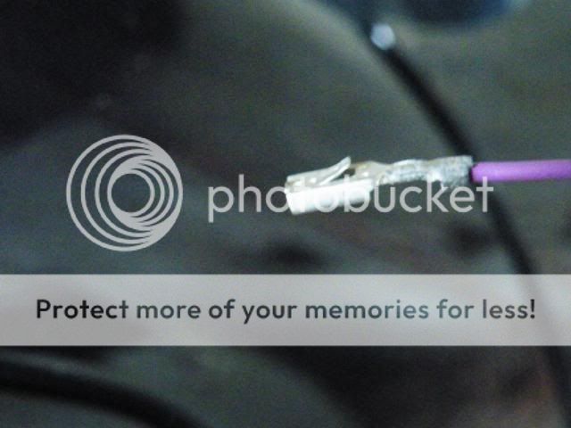

lift up the small piece on the connector and carefully remove the 3 wires,you may need to use a very small flat head to bend down the barb on the connector.im stripping the connector because i dont want to cut the wires and is easy anyway...

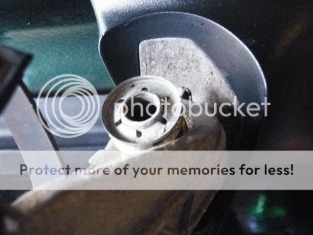

now you have this left

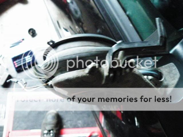

remove the spring and the clip holding it on,but be careful not to brake the clip.a bit of pressure with a flat head,dont worry,its not going to take the eye out of ya!

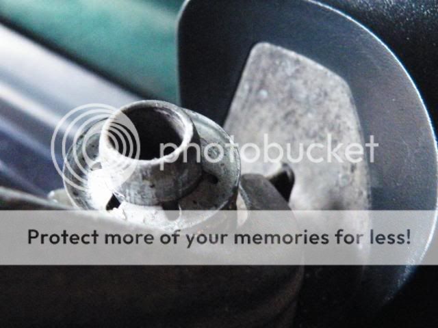

lift off the arm and youve got this far
and this is whats removed!

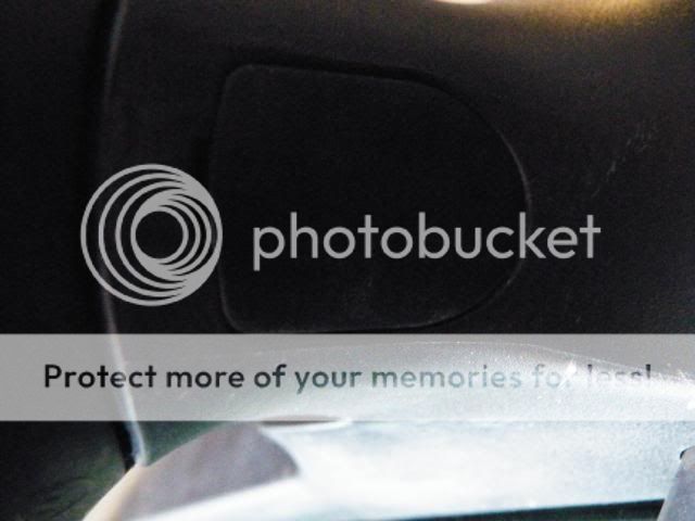

now! remove the small cover from the bottom of the back plate(the bit youve left on the door)

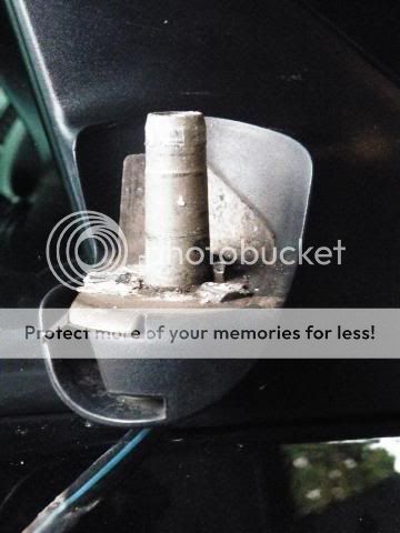

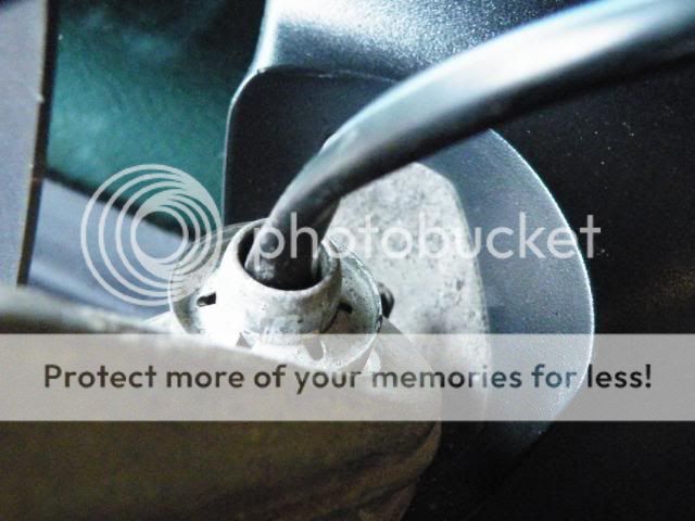

and pull out the loom(its the reason behind removing the connector)the loom wont pull out past the spring and clip.

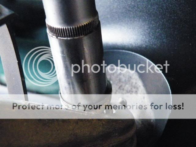

stick on youre stubby arm,spring and clip(use the spring and clip from the bora/golf)
place a deep socket on top and give it a belt of frank!a medium sized hammer,not a 15 pound slege!

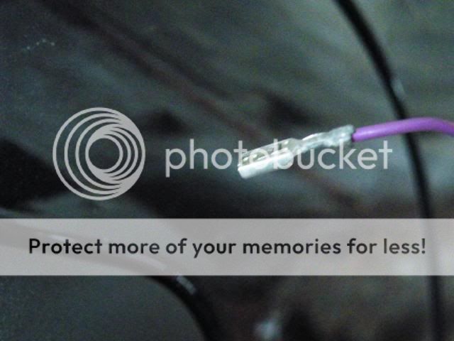

next thing to do is put back on the small white plastic connector,when you remove the 3 wires,the barbs will have been flattened,just lift the barb up a small bit so it will click into the connector

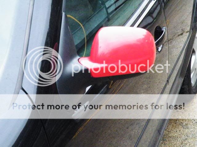

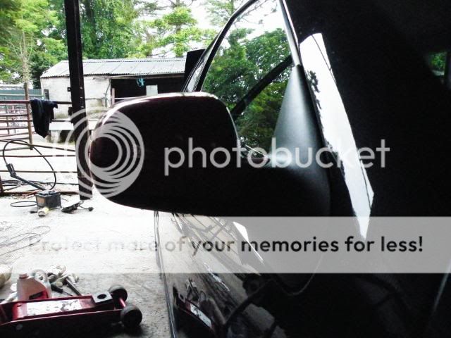

before
after

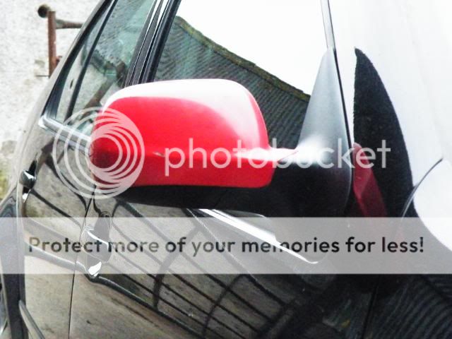

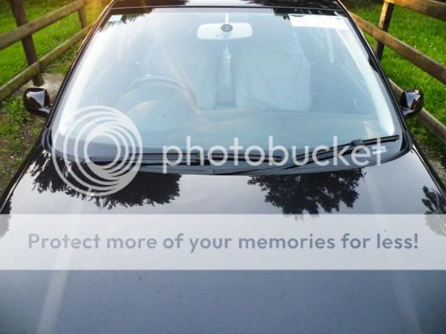

same for the other side......

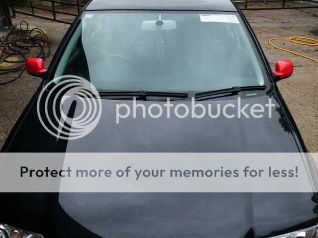

job done,now you have 2 stubby heated and electriclly adjusted mirrors!
all painted
