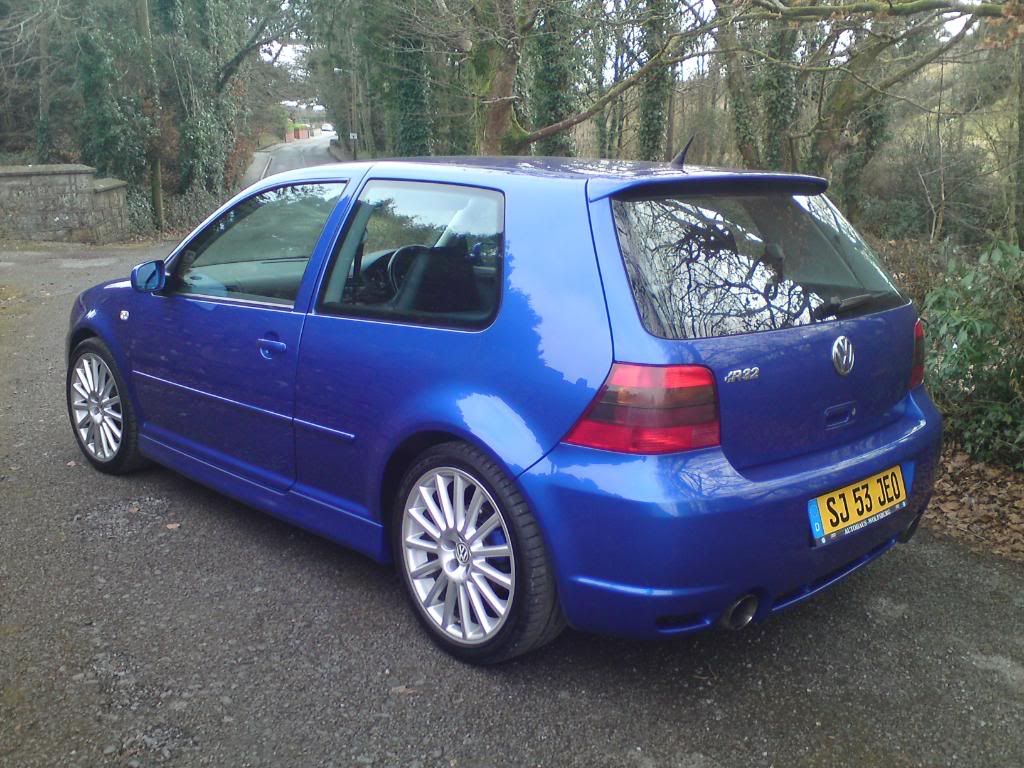

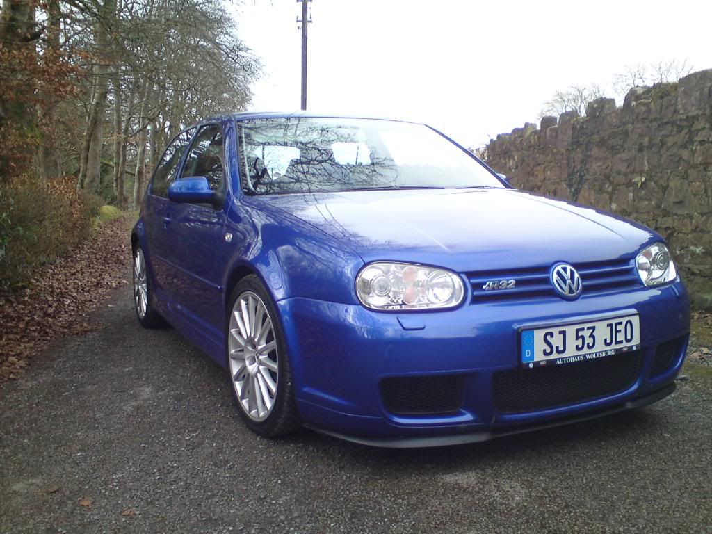

Finally sorted out a photobucket account so said I'd get a few pics up. Have the car just over a year now and kept it fairly standard until recently. I'll start with the spec, Deep Blue Pearl (the fastest colour) 53 plate, all the usual .:R refinements plus full leather and cruise control. Oh and of course 3 door!! The car had a non resonated milltek fitted aswell..
First thing to get sorted was the brakes as front discs were warped. Went with EBC turbo grooved with red stuff pads, goodrich braided lines and ATE Super Blue. EBC stuff was under half the price of OE and no loss in perfromance.

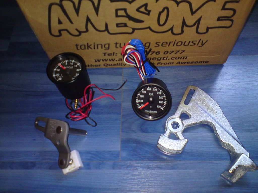

Then the modding bug began and ordered these few bits and pieces..

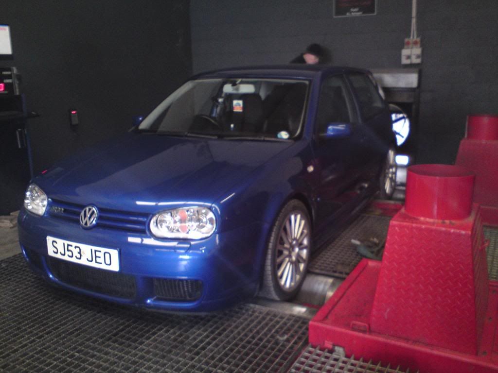

What did it dyno at ?

237.6 bhp and 216.3 lbft, down a little on standard and definetly not the smoothest torque curve I've ever seen but will be getting that looked after soon enough...

James did you dyno it in 2wd or 4wd? im guessing 4wd that would explain the low power and funny torque curve,the haldex sensing slip on the rear wheels and constantly trying to counter act it sending torque all over the place.
QUOTE (Shane @ Mar 15 2010, 01:50 AM) <{POST_SNAPBACK}>James did you dyno it in 2wd or 4wd? im guessing 4wd that would explain the low power and funny torque curve,the haldex sensing slip on the rear wheels and constantly trying to counter act it sending torque all over the place.
4WD, read somewhere that haldex didn't recommend doing dyno runs in 2WD. Got it done with AI Autosport up north who claimed they had no problems with haldex equipped cars and said they could get an accurate result... guess not. Seem more interested in there jap scrap up there anyway
QUOTE (james_r32 @ Mar 15 2010, 02:04 AM) <{POST_SNAPBACK}>4WD, read somewhere that haldex didn't recommend doing dyno runs in 2WD. Got it done with AI Autosport up north who claimed they had no problems with haldex equipped cars and said they could get an accurate result... guess not. Seem more interested in there jap scrap up there anyway
I've never read of a dyno that could accurately handle 4motion cars at least not in this country,i've no problem pulling the fuse for dyno runs - i've done it now for 4 or 5 runs with no issues,it's the only true way to get an accurate power reading from a 4motion car.
