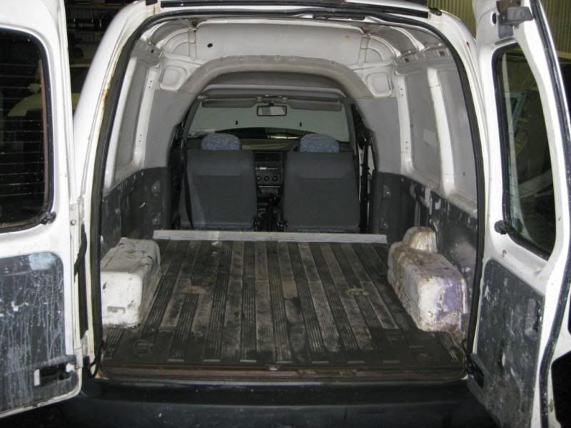

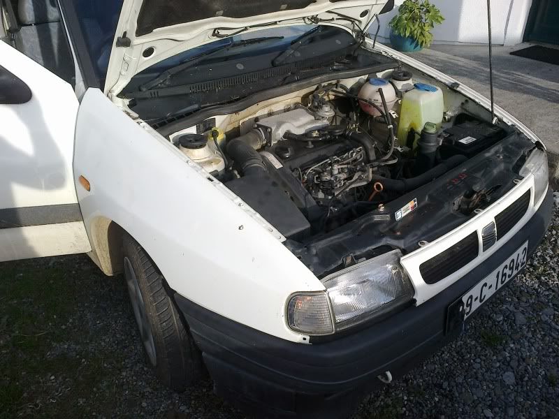

So, have been looking for one of these for a while as a general hobby/camping wagon....
Picked up this slightly sad, slightly damp example from one of the lads last weekend...
Engine is strong, 64 raging bhp from the go-forever 1.9 SDI engine, and she's driving well.....but she's a little worse for wear in the bodywork and interior decoration department....I have plenty plans to rectify that!
the obligatory 'before' pics...
Watch this space!
