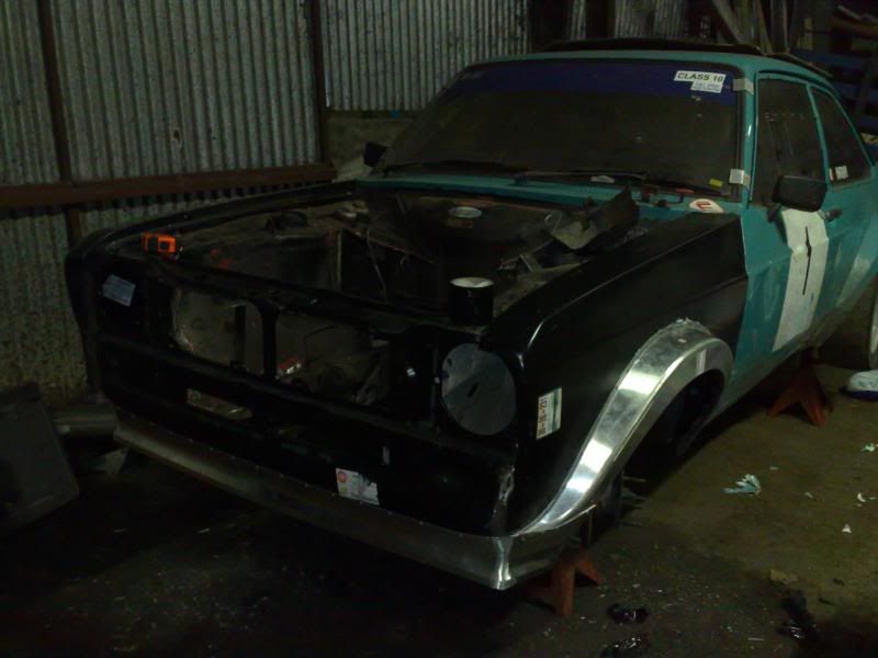

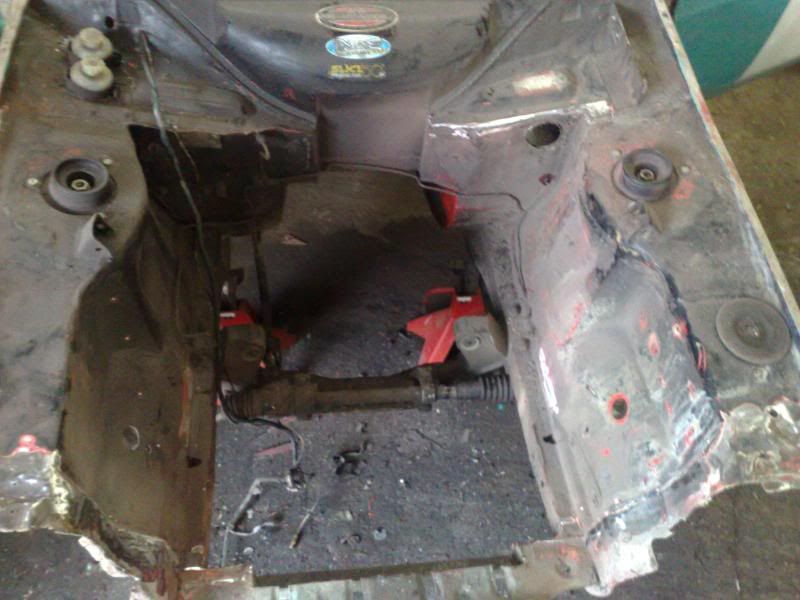

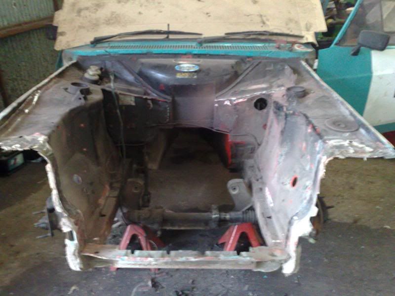

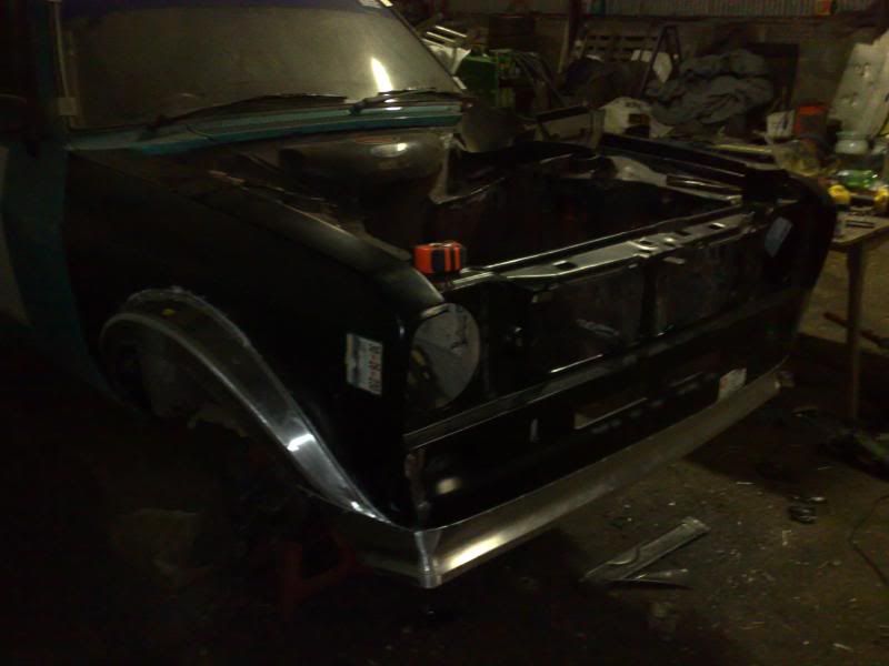

Stripped wings and front panel off,
Fitted new wings and front panel

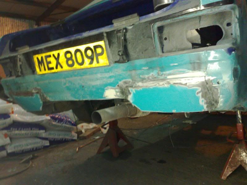

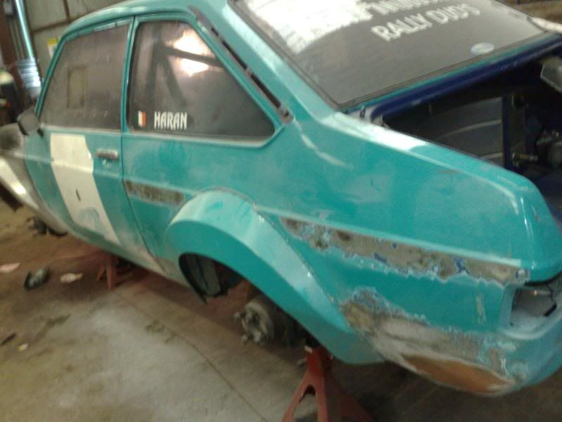

Welded in a few new bits to the back panel, coz i wasn't replacing the whole panel

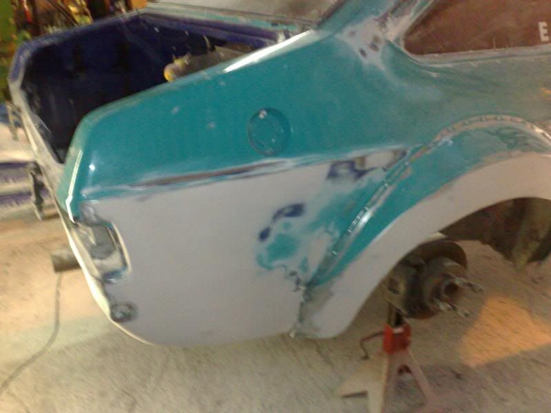

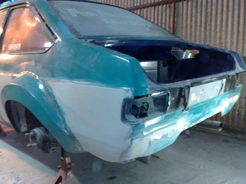

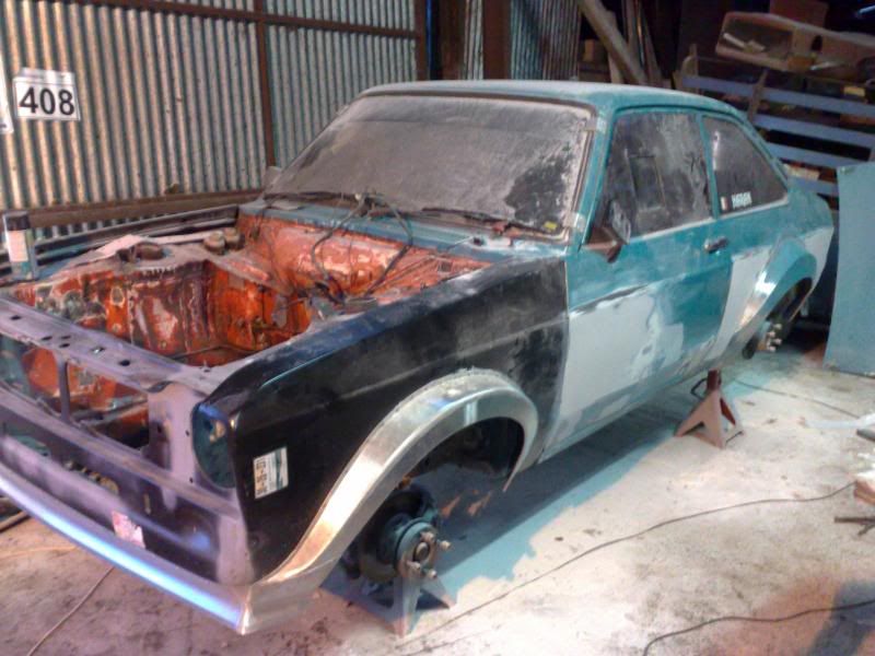

Started prep work on body

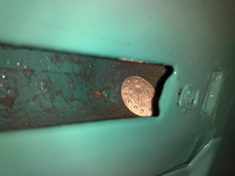

Found this in the quater panel so i think il leave it in there for good luck

So back to garage and the work began again

Just going back to your reg - what model was it originally Enda ? Was it a mexico or pure coincidence?
Looking at your shell and inner arches, RSs had support panel on top of inner wing at strut (or at least mine had) but the non RSs didn't afaik. Real week point especially if harder suspensions in place. I need to drive one again soon.
Keep an eye out for 175 DZA up your neck of the woods. It was red but who knows what colour it is now. It was a very clean shell when the lads bought it from me for rallying. I'd love to know what happened to it and it's engine. Still searching for OYI 461 RS MK2 aswell.
Aw mine was once a humble 1300 popular, just pure coincidence came with the car when i bought it back in 2004. Yup your right, non rs had a smaller hole for the top mount to fit in, rs's had a larger allowing for a better top mount, mine was just re-skinned with a rs top plate, im running 2'1/4" group4 coilovers and roller bearing alloy top mounts, aw god if you drive one again, thats it the horn will be on for another
