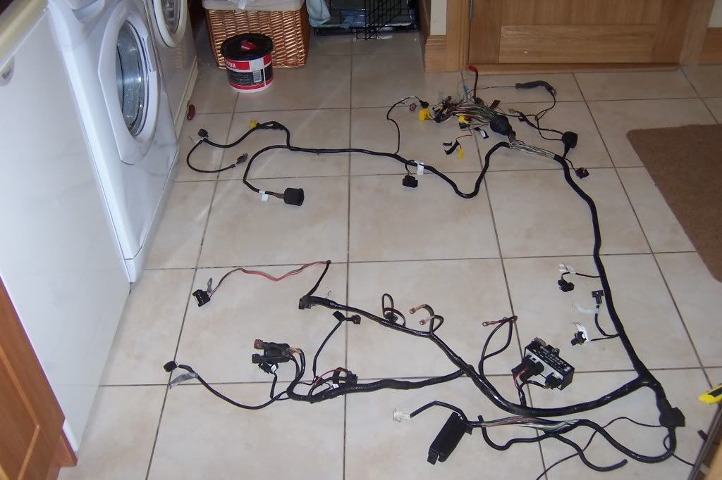

here is a pic of the mk3 engine loom laid out and tagged. i unwrapped the origional wrap and slightly reformed it to the mk2 bulkhead shape and rewrapped in genuine vw lom tape.
i used the complete mk3 loom as opposed to some abf conversions that separate the engine harness and add the mk2 lighting loom. i feel this is the best option as all the fusebox connectors fit as per the mk2 and you get the benefit of an uprated headlight loom as well.
the side repeater cables are already in the mk3 also as my car didnt come with them fitted.
the light connectors will have to be interchanged for mk2 items but that wont be a big deal really.

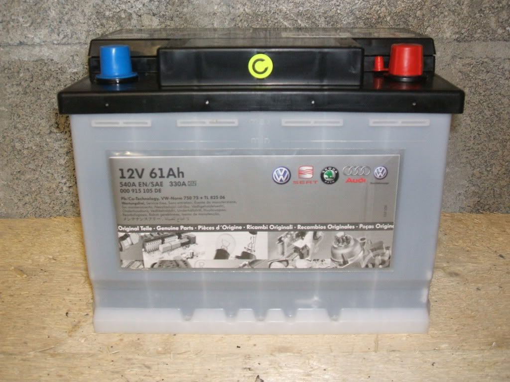

bought a vw battery for it and got a corrado vr6 battery cover off t.d

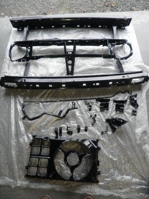

QUOTE (bri @ Apr 10 2011, 02:40 PM) <{POST_SNAPBACK}>powder coated bits back. fitting them up at the moment.
thanks to mossey for dropping off /picking them up from tpc!
I was looking at all this stuff in TPC last tuesday, gave your front panel a good inspection too.
I could have brought it with me if I know it was your stuff.
Nice to see it in the final stages at last.

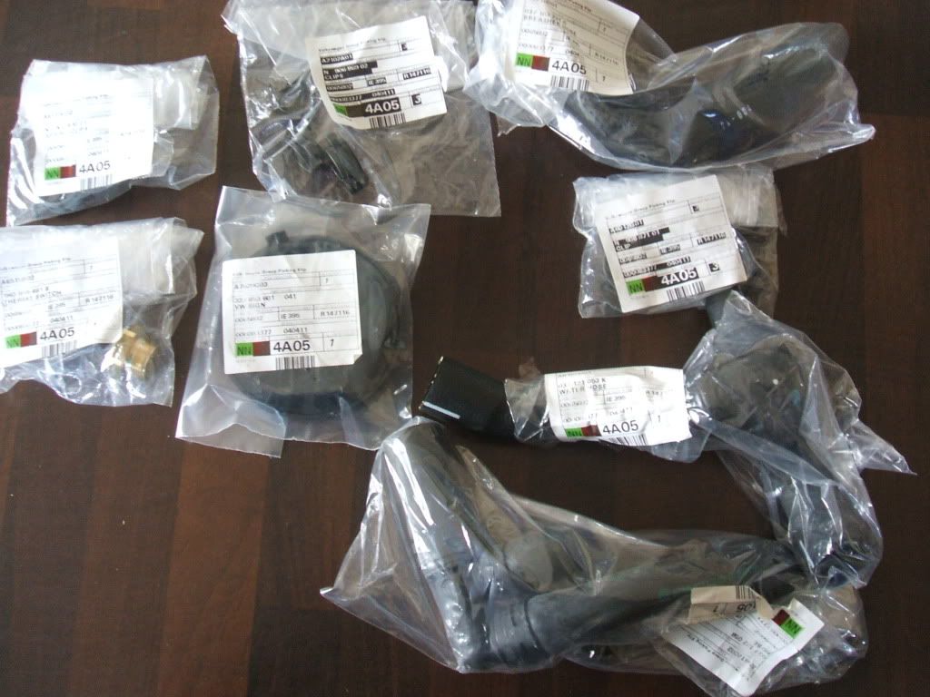

some new parts .
new coolant hoses,
set of oe hose clips
crankcase vent hose
abf rad temp switch.
also not pictured ,new rad and top and bottom rad hoses.

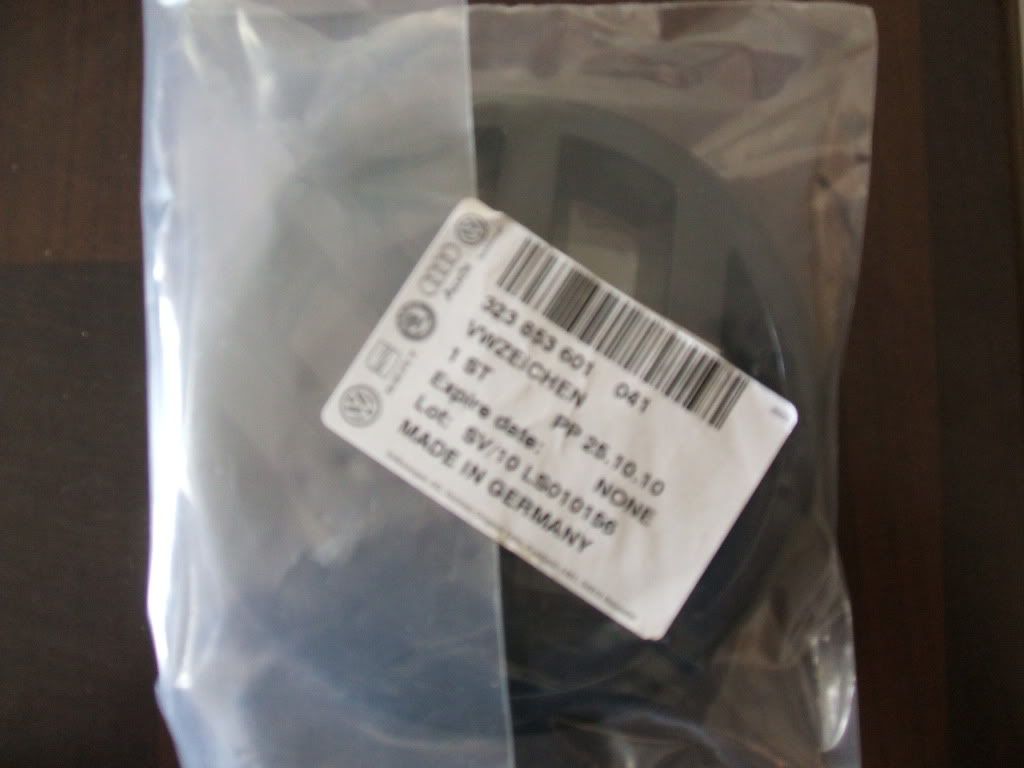

bought a new black vw grille badge while they are still available
crappy pic with all above fitted.

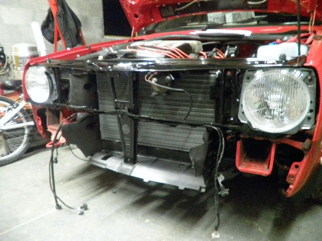

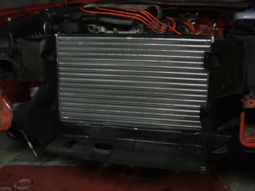

more progress this week.

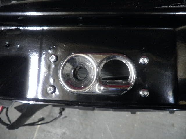

fittted the powdercoated slam panel with freshly painted fixing bolts and used some stainless items for the rad fixing brackets.
modified the mk3 lighting loom to accept the mk2 lights,indicators,foglights and horns.
also bought some new front end items.

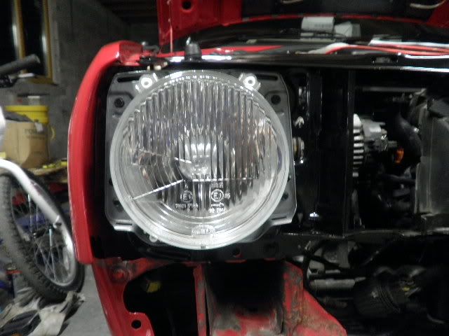

bnib hella headlamps
as new hella foglights
as new rallye smoked indicators.

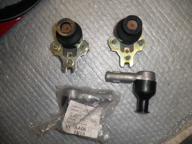

new vw tie rods and wishbones balljoints.
thanks to neilo for the parts and to t.d for dropping them over to me during the week.
tadgh also gave me a hand to get some of the front end built up with the above parts.

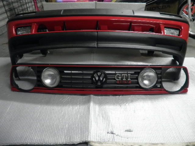

headlamps fitted:
already had a new genuine grille so swapped over my existing innerlamps as they are still pretty good,fitted new centre badge and 16v gti badge and lower strip.

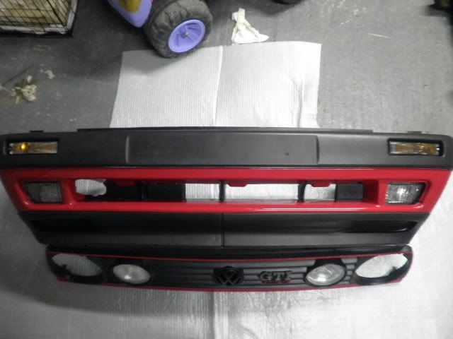

built up the front bumper with indicators,foglamps,lower spoilers and black trims.
we trial fitted all up to the car and i must admit it looked very tidy, the new headlamps and grille really lift the appearance of the car.
i have removed off again as im waiting on a pair of replacement side clips for the bumper and a pair of slam panel fixing grommets and screws for the grille also ran out of vw loom tape for the lighting loom so waiting on that to come in to complete wrapping.
pic of balljoints.

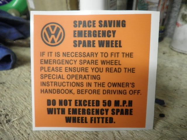

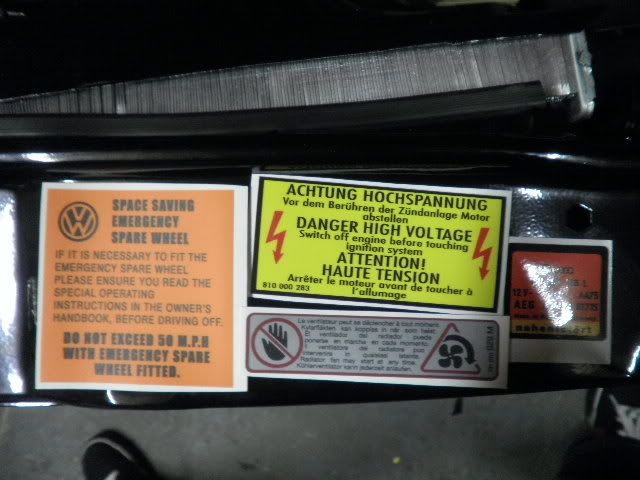

set of new underbonnet stickers arrived also:
anyone know where this one is supposed to be located? i am using a spacesaver btw.
