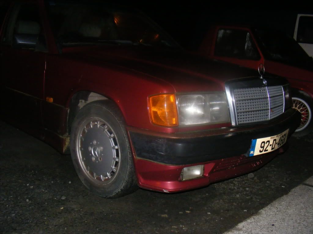

well, I bought this car off a friend of my old fellas -nearely 2 years ago now (doesnt time fly hey... clock only goes one way and all that....);

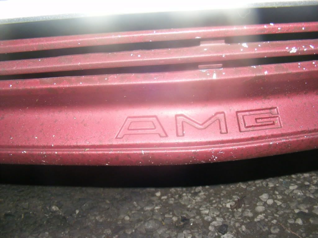

I was clicking the heels with 'self satisfaction' that Id bagged such a relativeley low mileage Merc 190E, especially one with a dealer fitted AMG kit...
The day after I got it, all chuffed with myself, I even gave it a wash, which is a real treat, for any car that has my name on the logbook;
I promised Id get it road worthy, improve it generally and point the the old bus on a forward pointing path generally....
....in reality, this ended up on an often sideways pointing path (on private motorway bypasses)....occasionally...

Cheers lads; day after I got it I fired up the hairdryer and got rid of the '1.8' badge; performance gains were immediateley noticeable
... I might buy an AMG badge off of e-bay to go where the '1.8' once was, but Ive promised no more procrastination or frivolty till I get the the suspension bits, brakes etc sorted, and go before the NCT judges...!!

nice clean merc you have, getting rare , its very easy to loose interest in things in my own experience, would be a nice daily , set of coils and plates and a good polish -enjoy
@Tom - Arthur Daly? I have no idea what the Pulitzer Prize-winning columnist of the New York Times has to with the context of this thread....
@J.Lyons - i was told its already had a 'dealer supplied' lowering kit fitted, but it looks like replacent front springs maybe; the rims did exaggerate the 'tail dragging' stance... I hear you re; motorviation- I have a few other cars to mess with/fix/break bits on/render useless; so plenty of other distraction, cars wise...

Cool car that.
always liked these, and this looks a good one.

is it me or the wheels look very 'forward' in the arches??

QUOTE is it me or the wheels look very 'forward' in the arches??
I thought that when looking at the pics; theres big section tyres on and the avenue there is on a slight slope, added to me proberley takin pics 'feckways' as it didnt so much look that way 'in real life'
