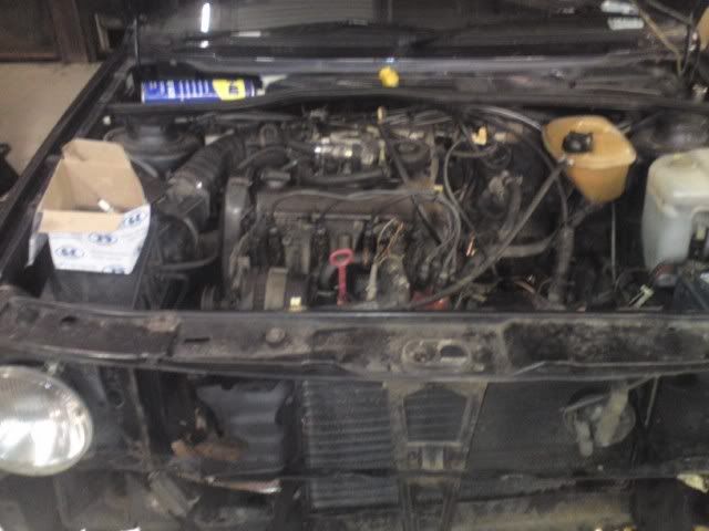

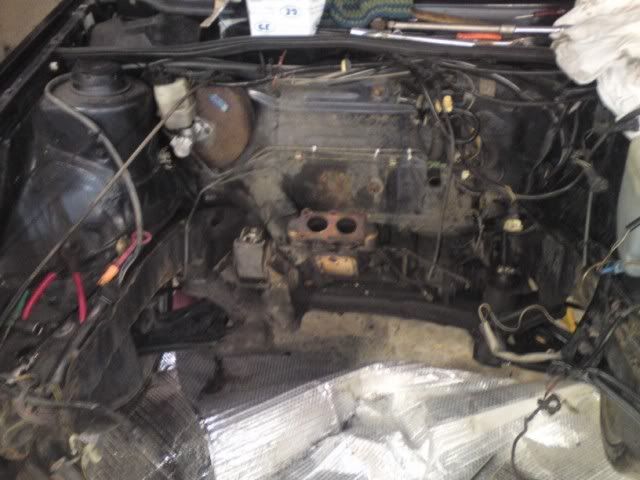

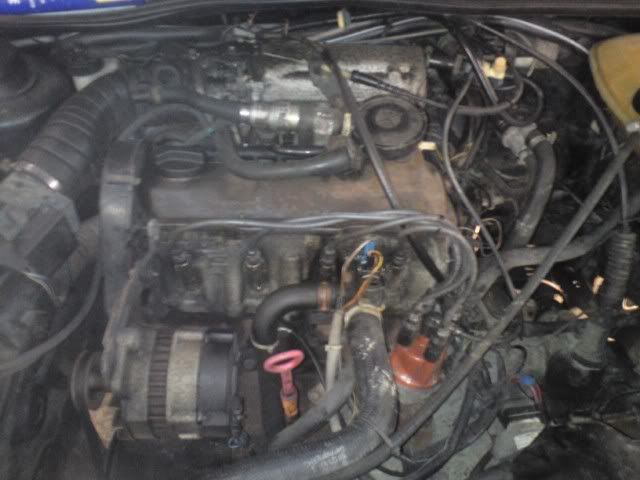

i started by stripping the front end

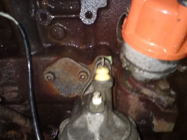

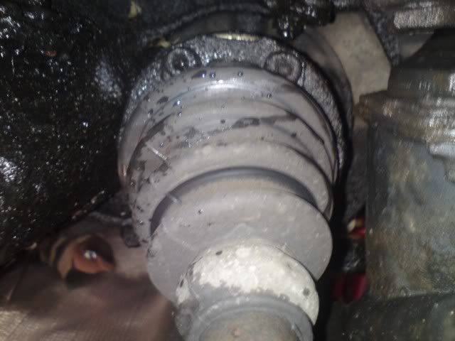

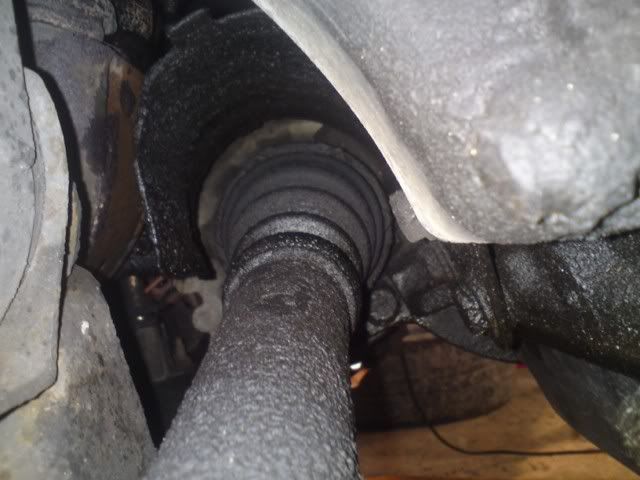

founf that the driveshaft seals were shot

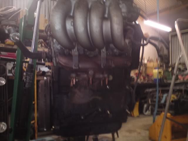

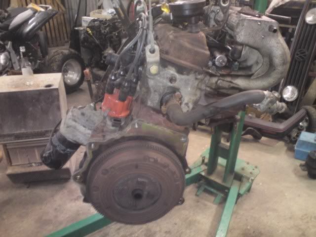

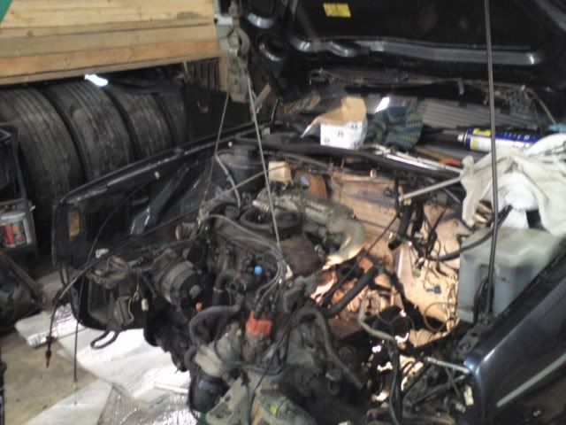

front end stripped out and engine hanging

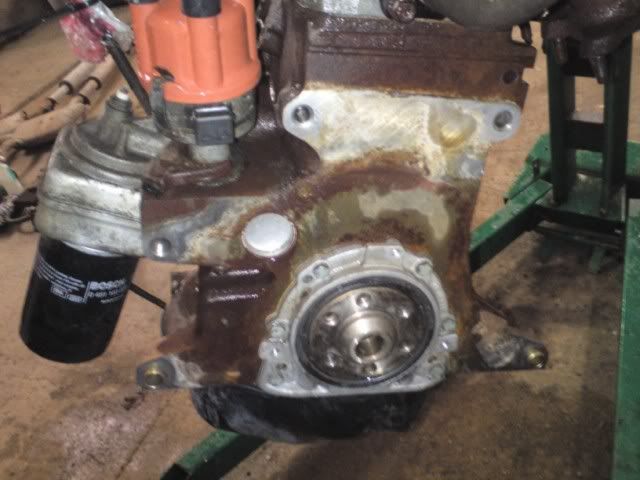

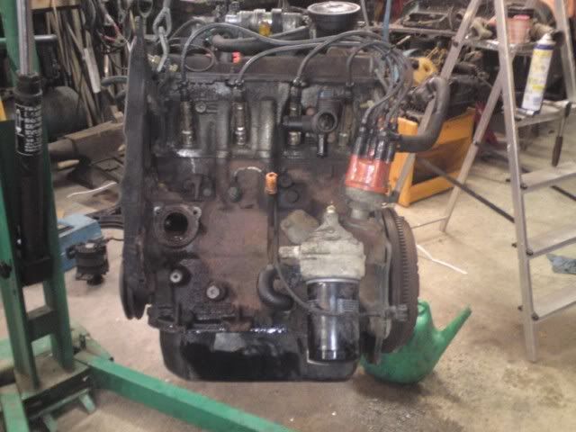

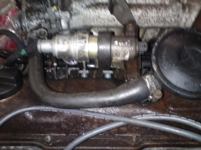

engine out doesnt look too bad

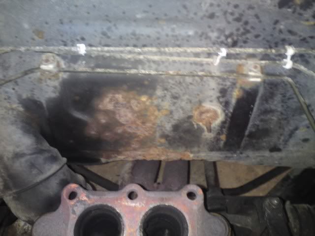

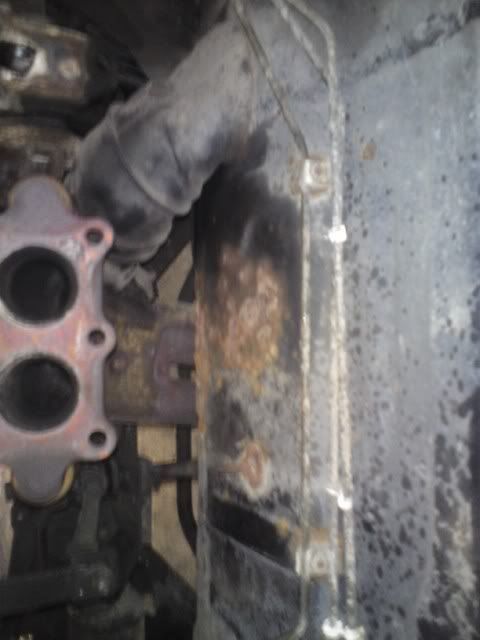

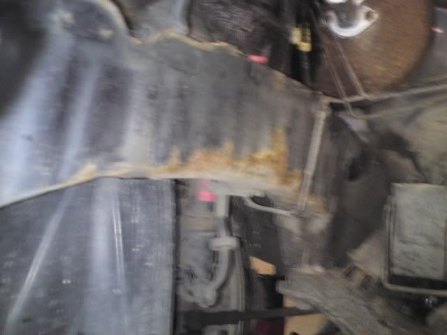

a bit of rot caused by heat i think
surface rust

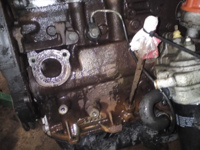

broke the the dip stick:

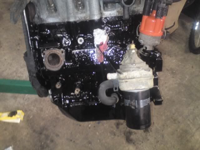

decided to paint the engine so here is before..
after paint

i also put in a sachs clutch and main oil seal

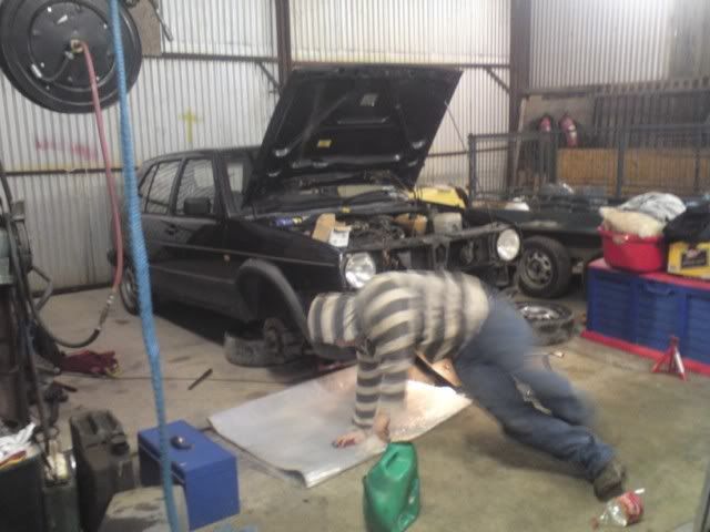

Nice one but as regards your first photo..
its not a good idea to breakdance near a car on axle stands.
