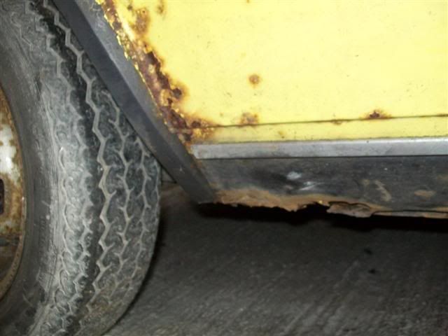

just looking at that picture above, I'm going to paint the sills yellow, it'll make the car look another 4" lower without doing a thing to the suspension. There's just some black stone-chip paint brush-painted on there at the moment...

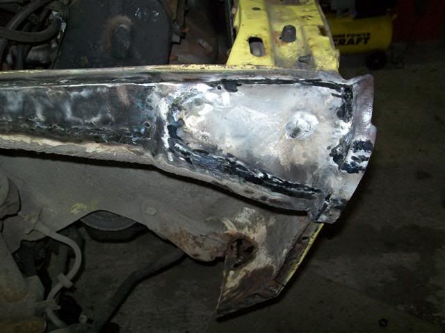

just the bits I've welded and need to be touched in to match the rest. Not even going to wash it, it's got lovely algae on the bonnet and boot
[quote just the bits I've welded and need to be touched in to match the rest. Not even going to wash it, it's got lovely algae on the bonnet and boot [/quote]
nice work and progress on it trev... ...Im a big fan of that 'finish' -good choice!!
