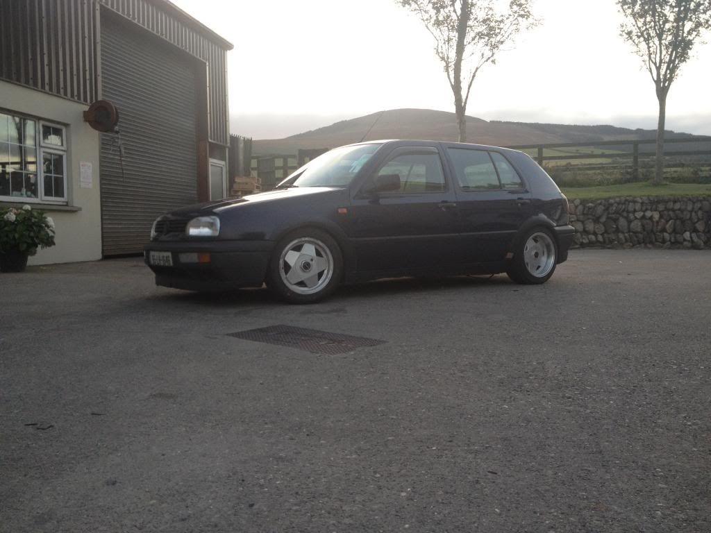

bought this at start of year and did few small bits to it, needs abit of tidying
already had:
jom coilovers
gti interior
vento front
black rotas
plan is to make it into full gti rep and drop her on 8" borbets
Heres few pics all comments welcome and give me few suggestions

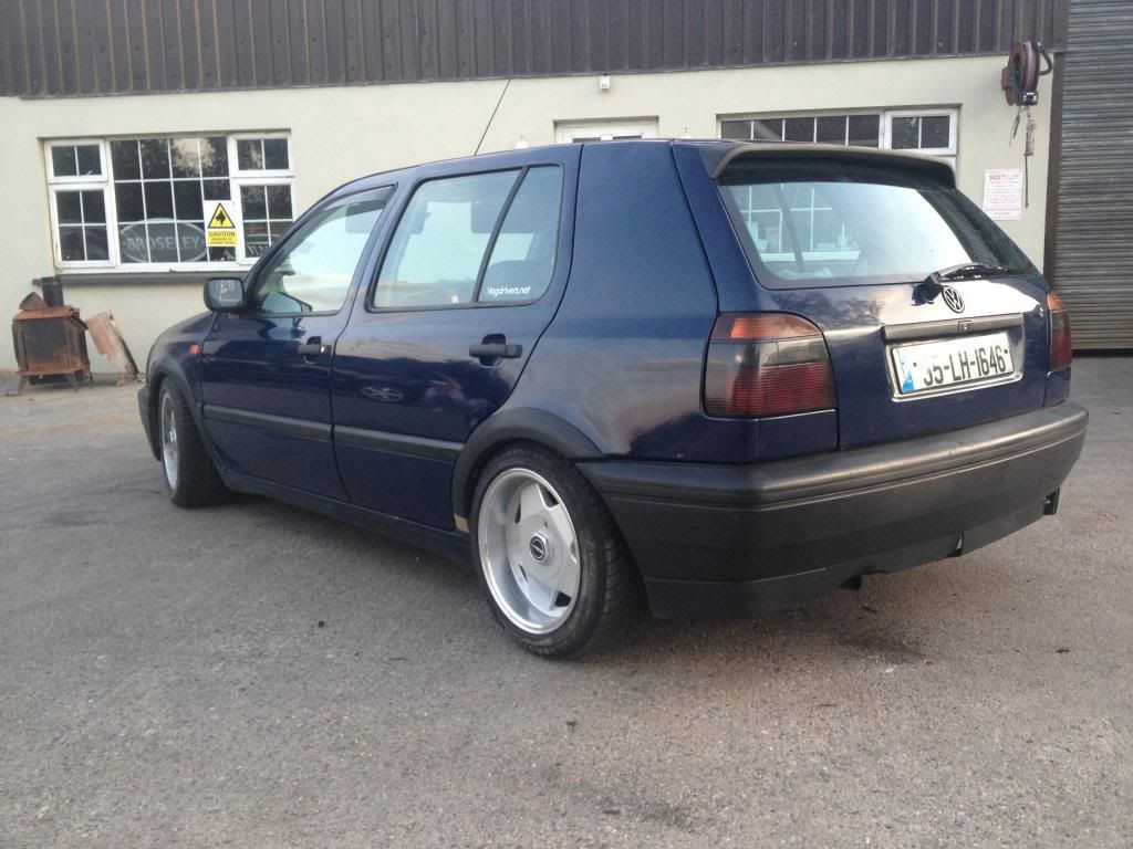

i have orderd 175/50/r15 for the borbets as there 195/50 and the back are rubing arches with no one in the back so had to rise it up 10mm,
this is car going to dubshed, i had to borrow my freinds 7j borbets for front as 8 to wide at moment,
plan is to cut and roll arches and fit gti arches,

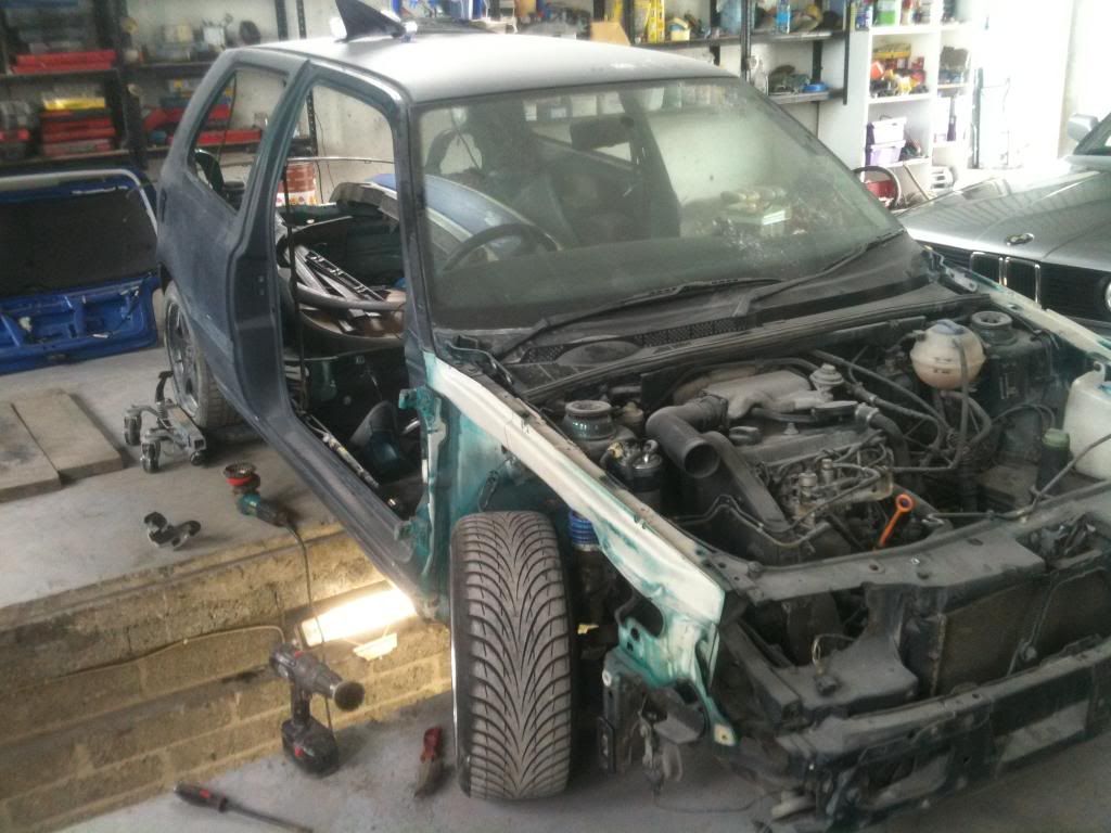

so been while since i updated, got job in panel beaters for summer so been working on this in spare time,
plan was to tidy up few small bits but has turned into full repsray,
was going to spray it green again as its the easiest way and would look well but im thinkin of going for ether dark blue, black with purple tint or gunbarrell grey?

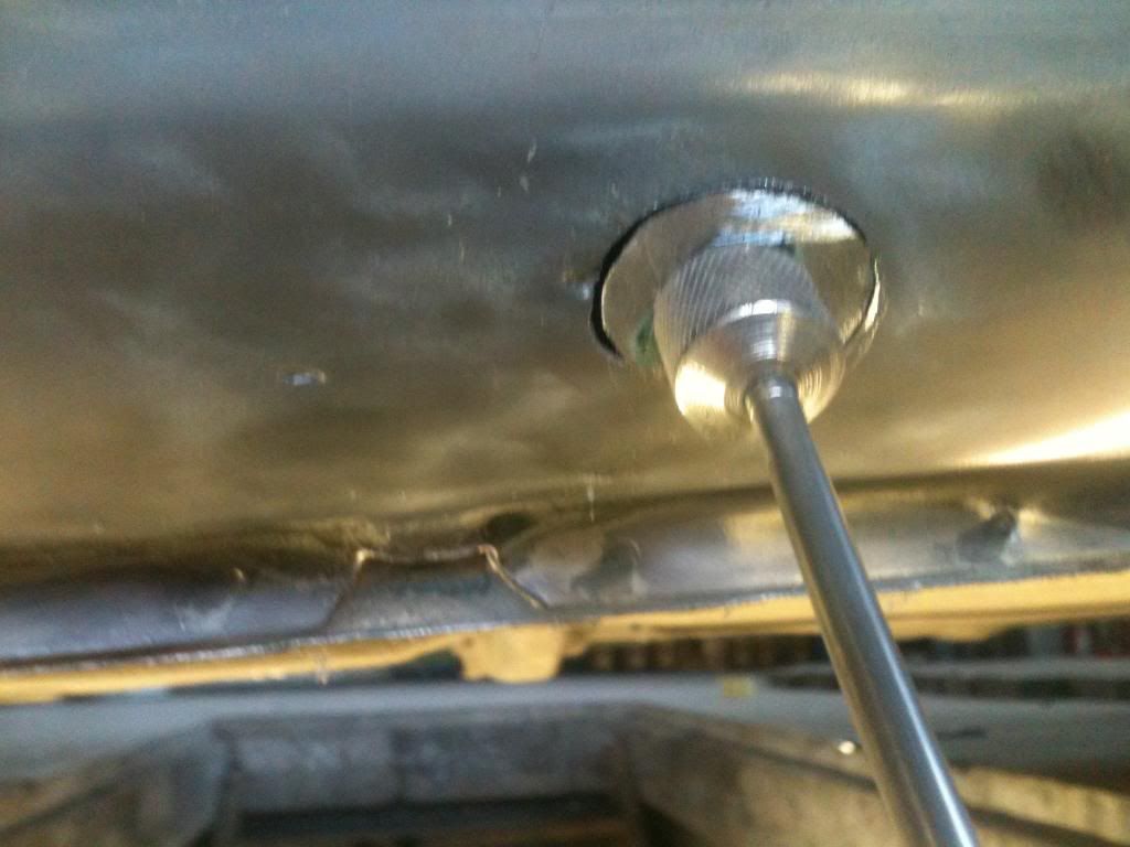

car is just about ready for primer i decided to remove wiper in the boot and flush the hole for cleaner look and also rolled front and back arches so no more rubbin hopfully,

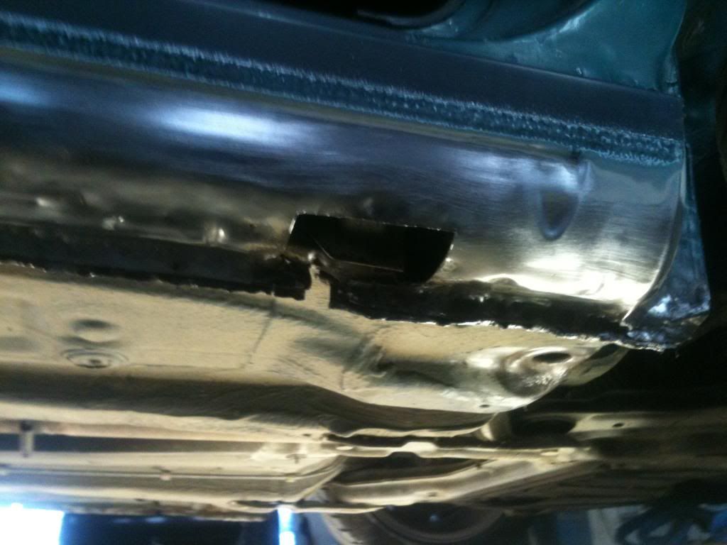

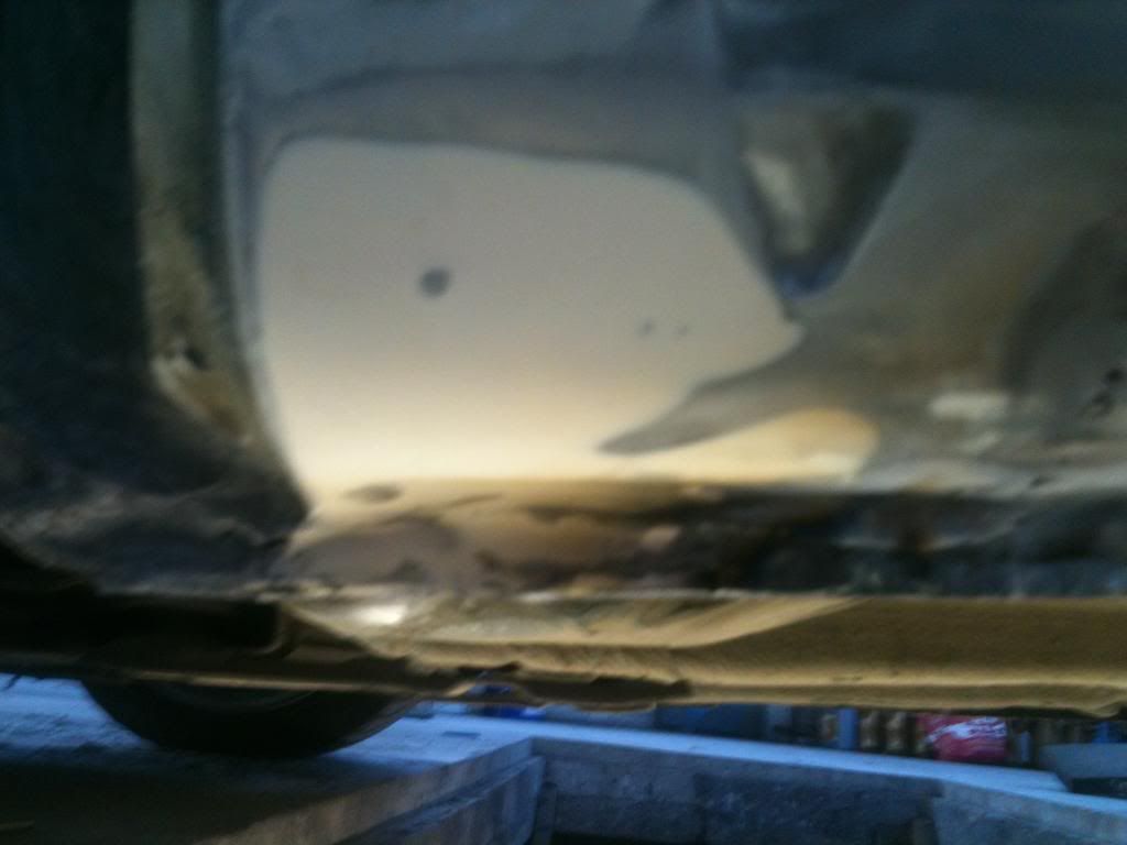

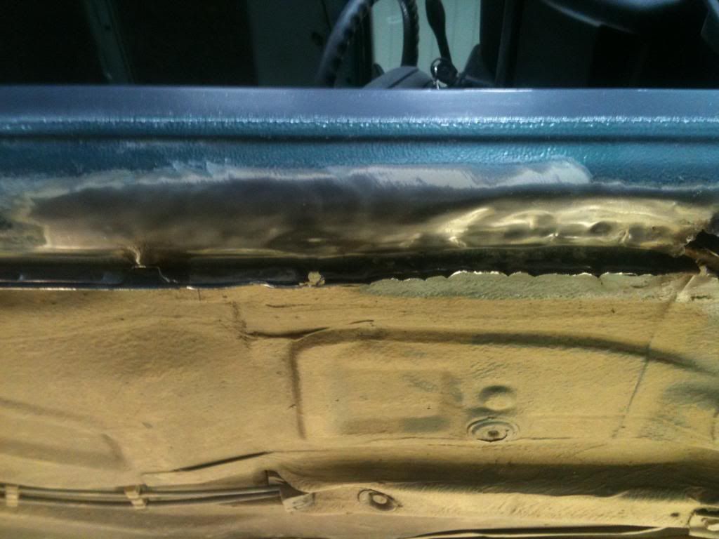

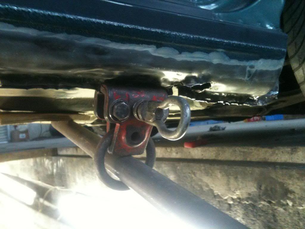

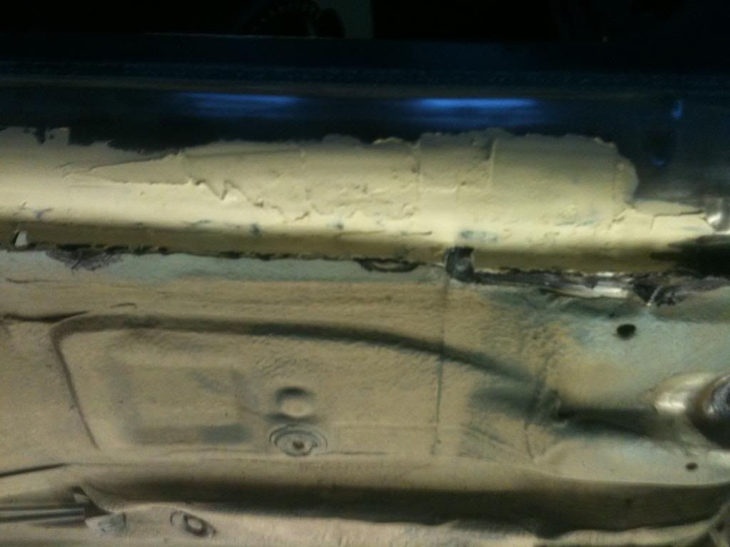

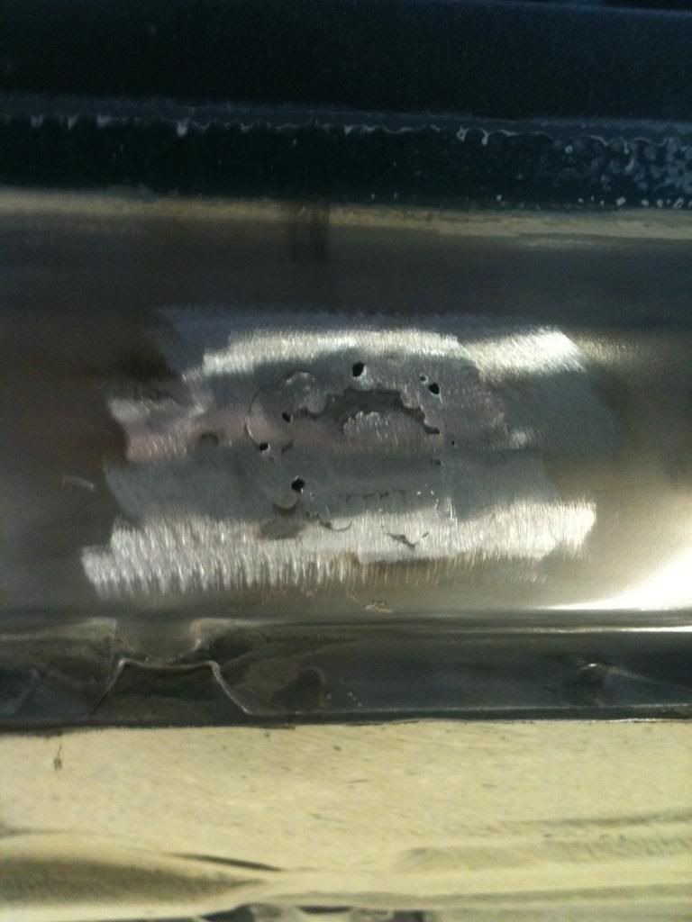

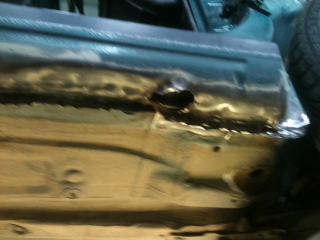

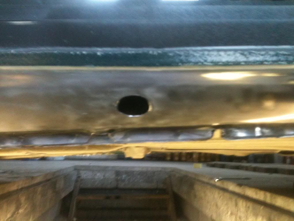

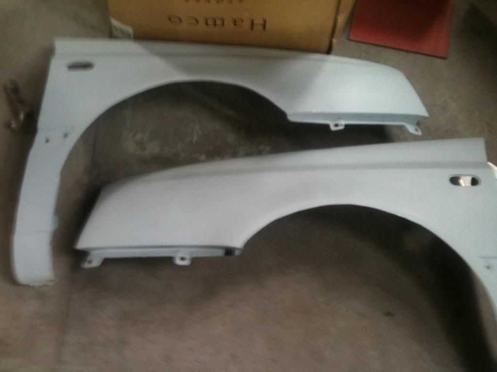

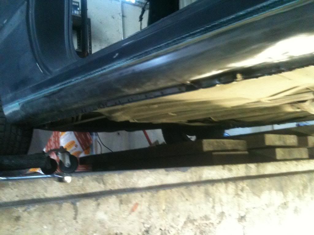

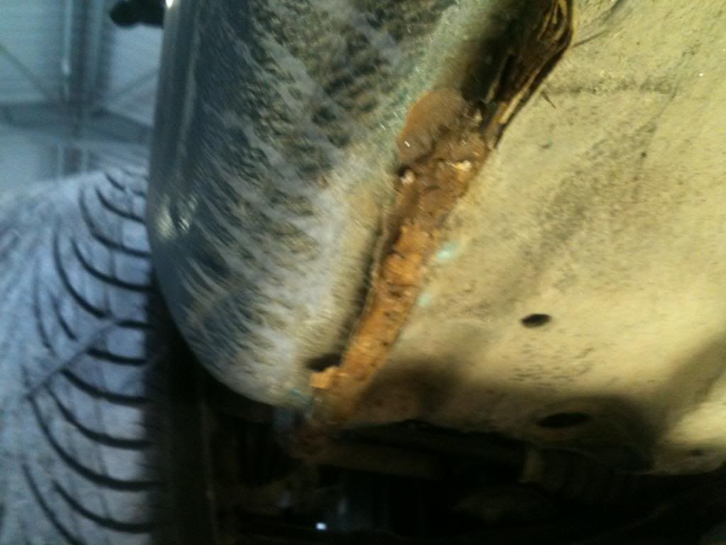

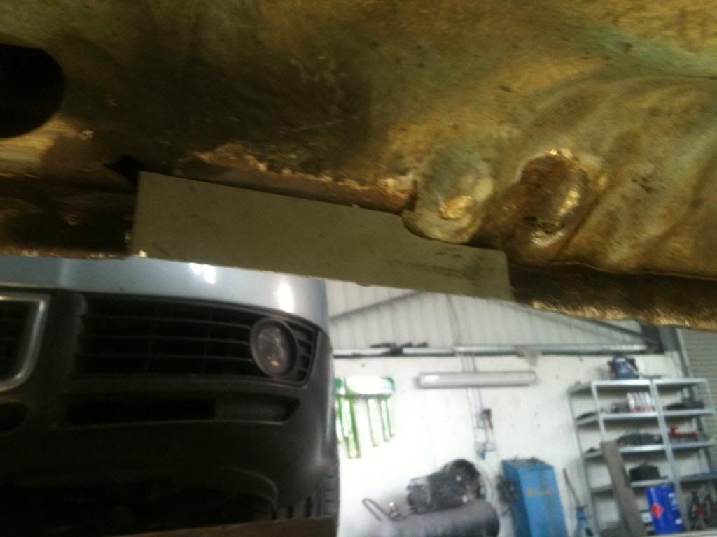

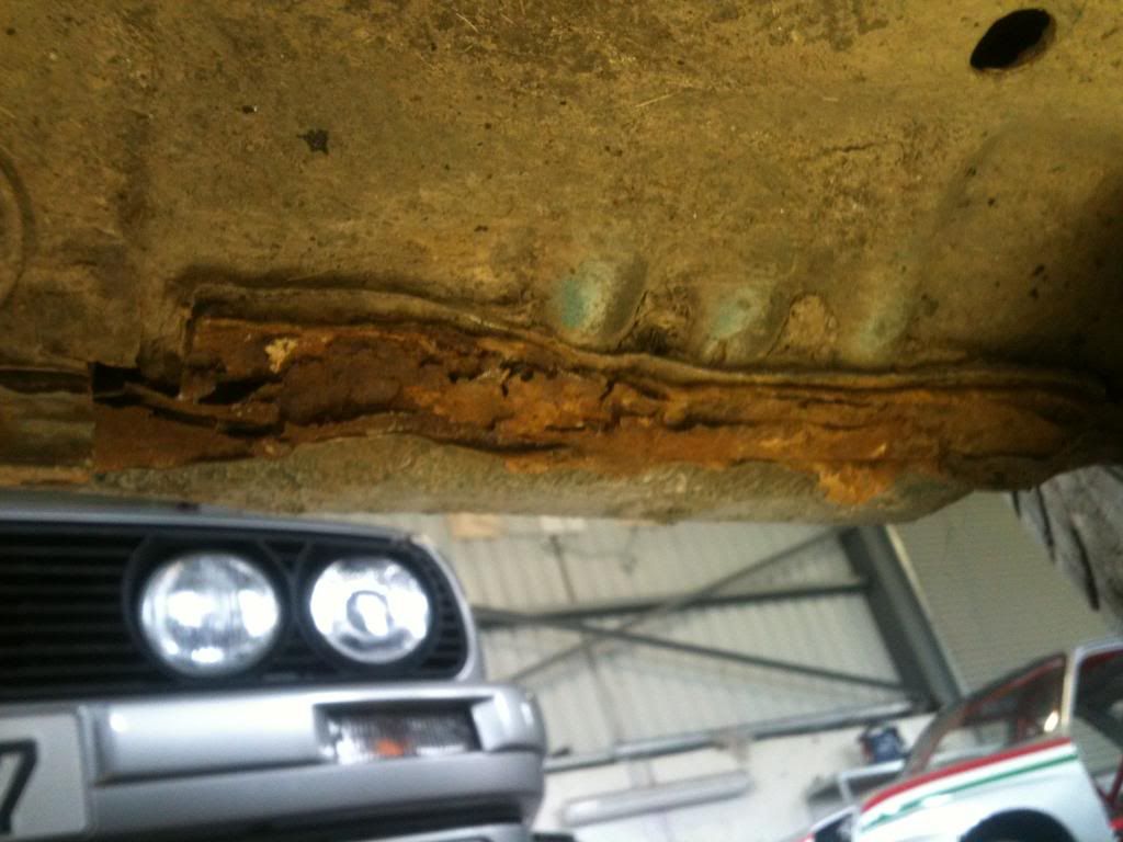

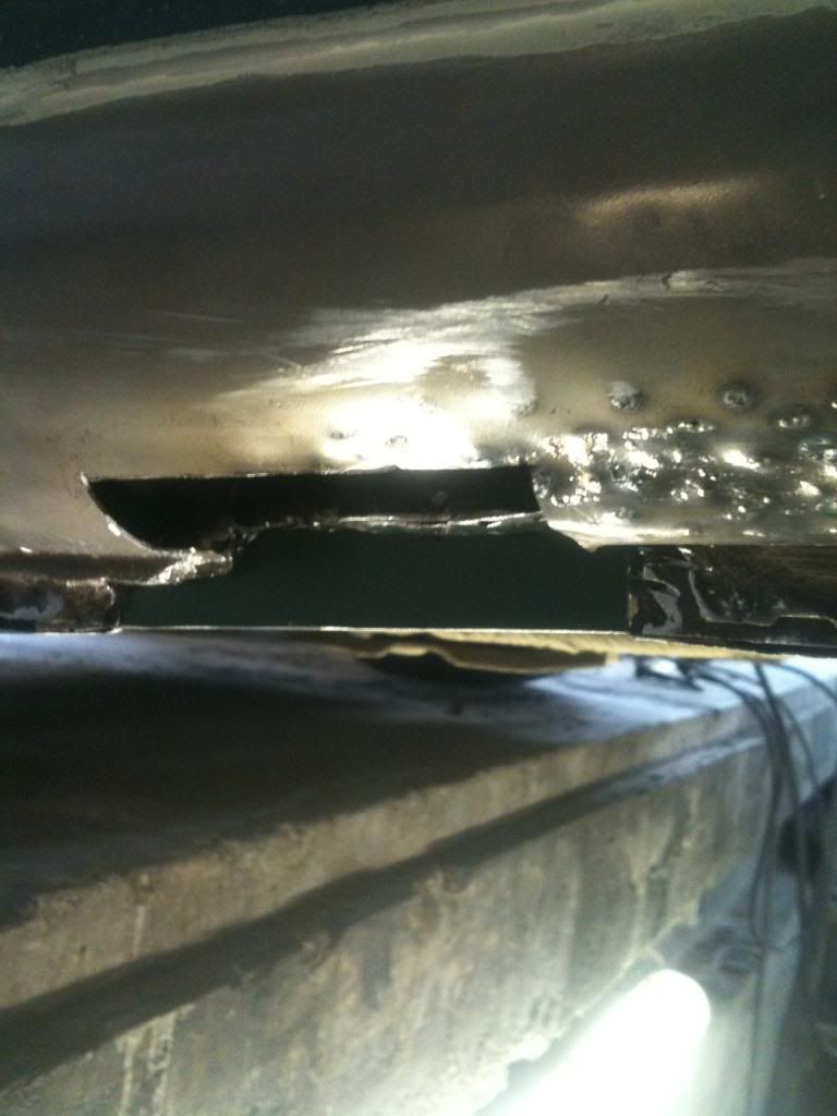

Small update had two weeks off collage so called up to panel beaters and did bit work on the car,

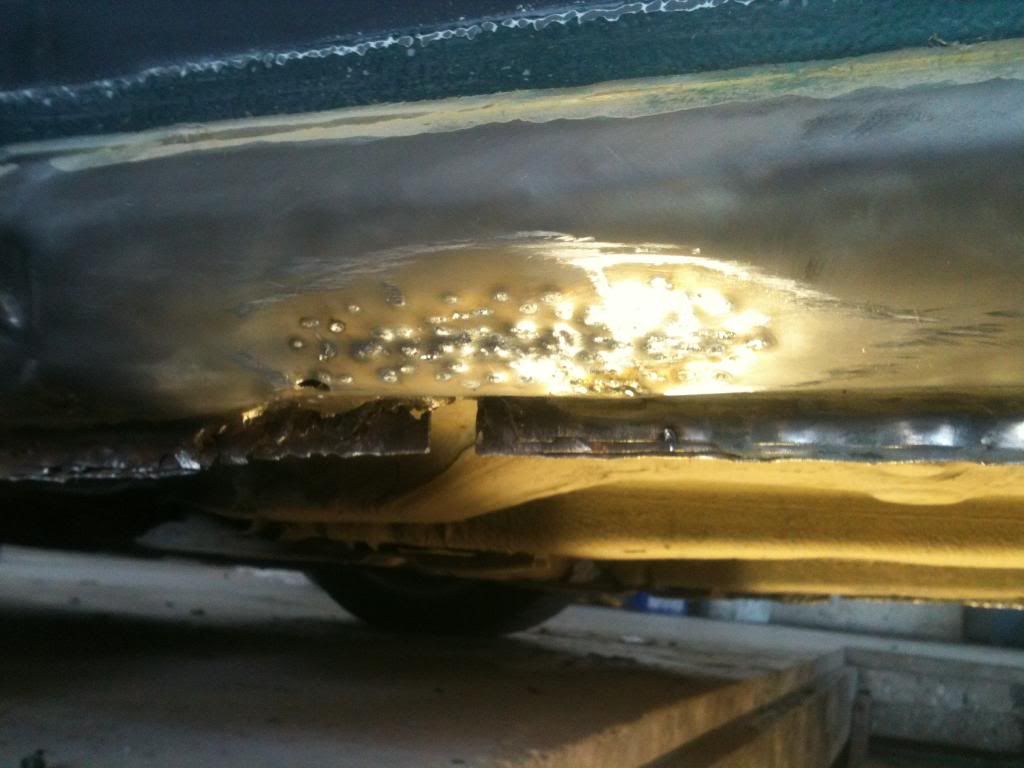

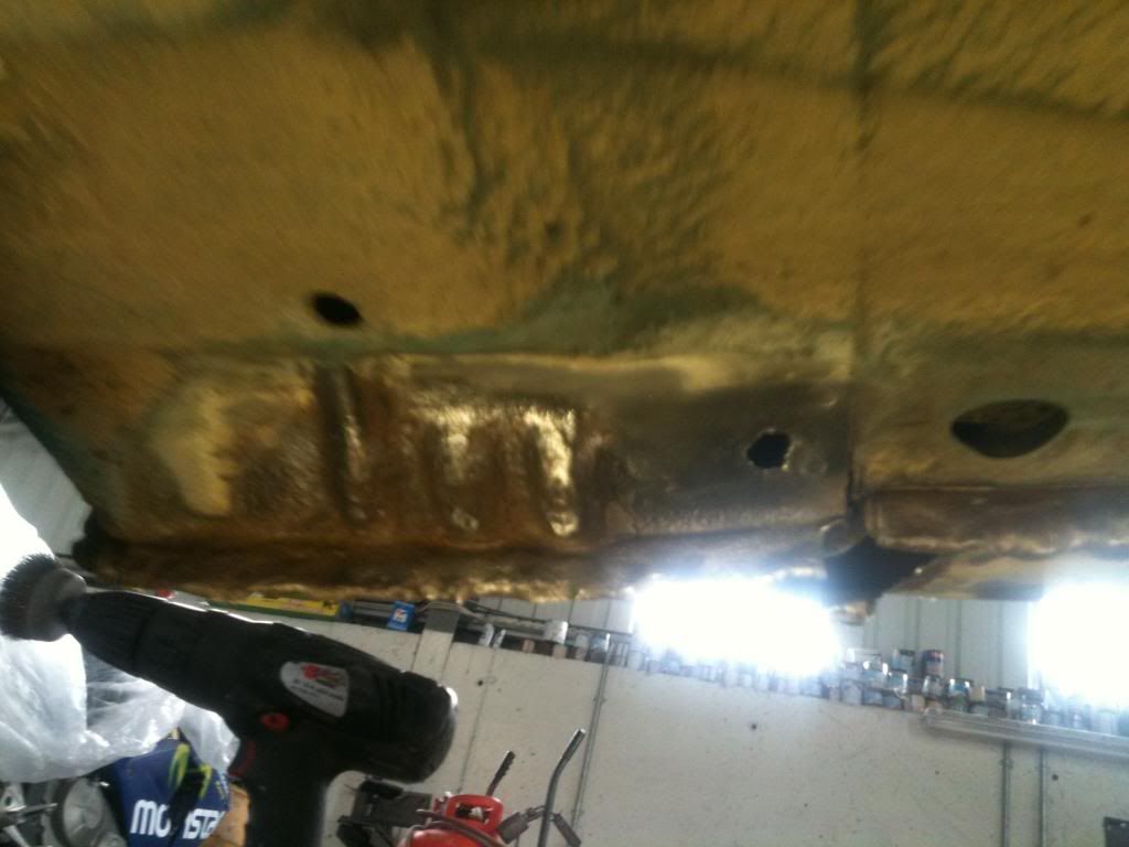

There was few bits of rust in cills and were pushed up from going over ramps,

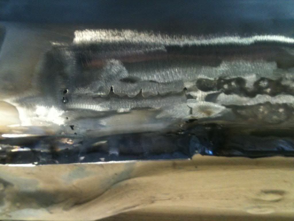

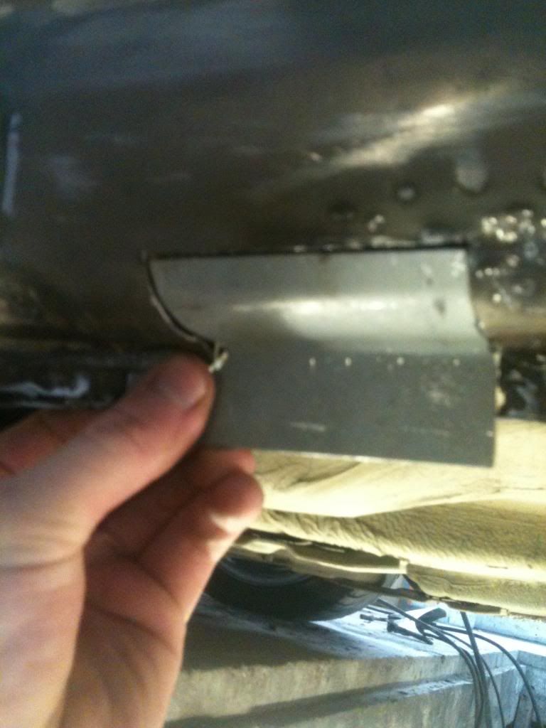

So first grinded off stonechip on both sides and pulled out the dents and got them stright then cut out rust and got thomas to weld in new plates,
then grind down welds, fill them, and sand them, then few coats 2 pac primer
Then got front,back bumper, spoiler, petrol flap, grill, mirrors, number plate light surround all primed aswell,
Got few bits flatend down but still good bit of flatining to be done beofore base coat but getting there,
Few pics.. comments welcome.

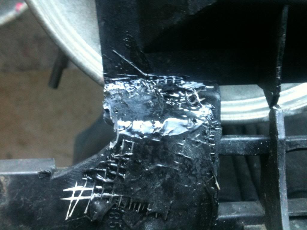

Grill was cracked on corner so filled it with plastic at back,

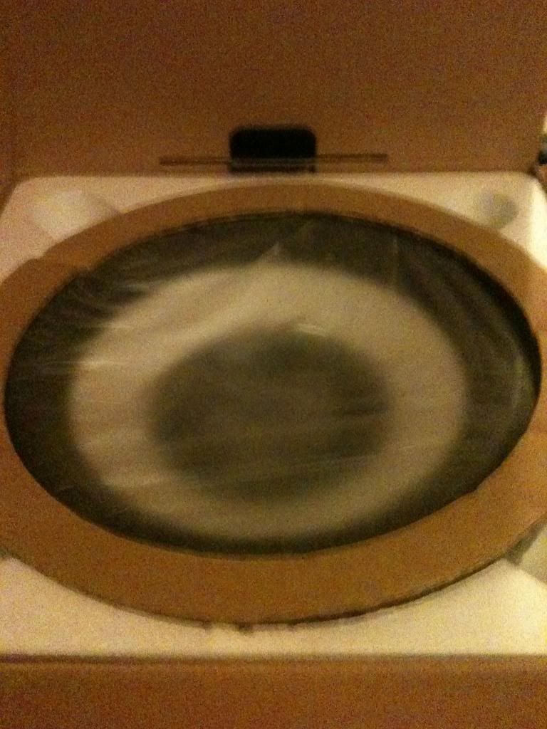

Picked these up aswel, 2 12 inch subs and matching 6x9,
Thats all for now..
