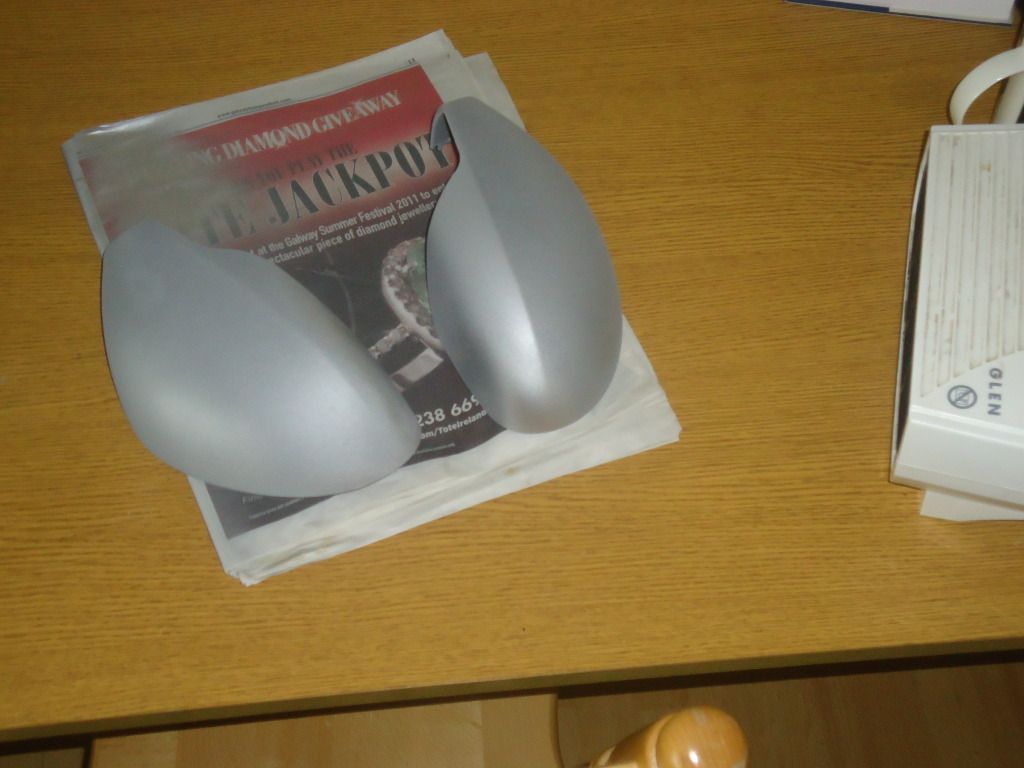

FR mirrors sprayed up.
Put on

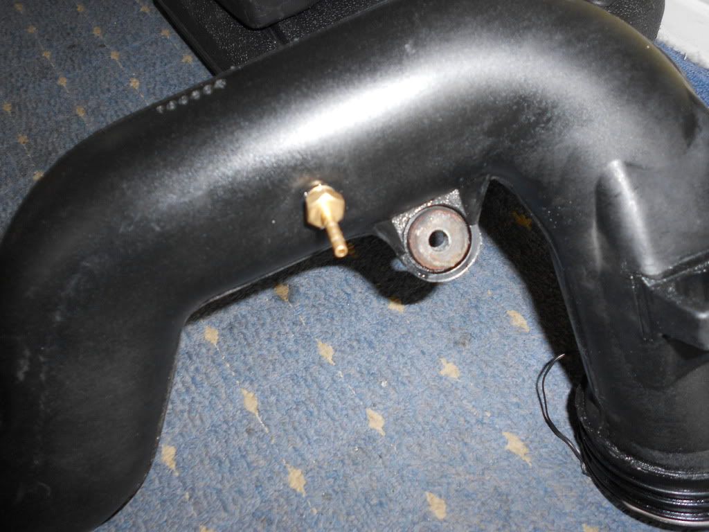

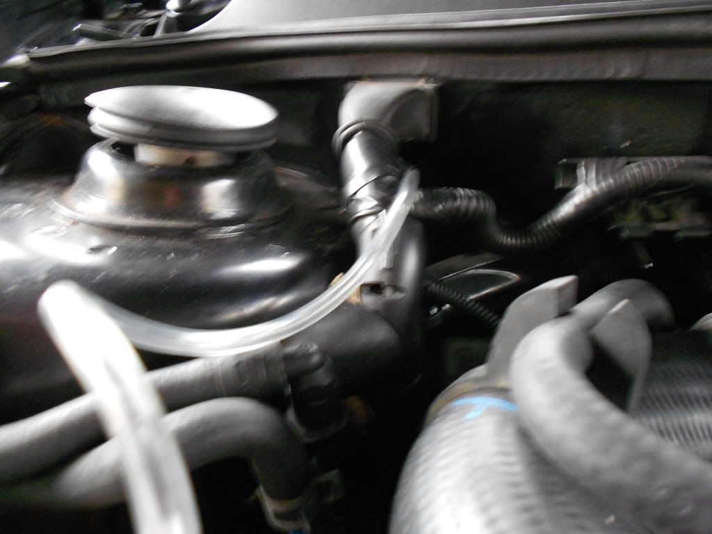

Autogauge Boost Gauge Installation
Some other essentials: PFTE Tape, 1/8 inch hosetail to take air from plastic intercooler pipe. Anti-judder t-piece, 1/8" air pipe, 4 electrical connectors to connect gauge wires to dimmer switch in dash.
Drilled and tapped intercooler pipe and a bit of locktite on the threads:
Attach air pipe:
Send pipe in under the wipers and bore hole through rubber/plastic grommet and send into dash.
