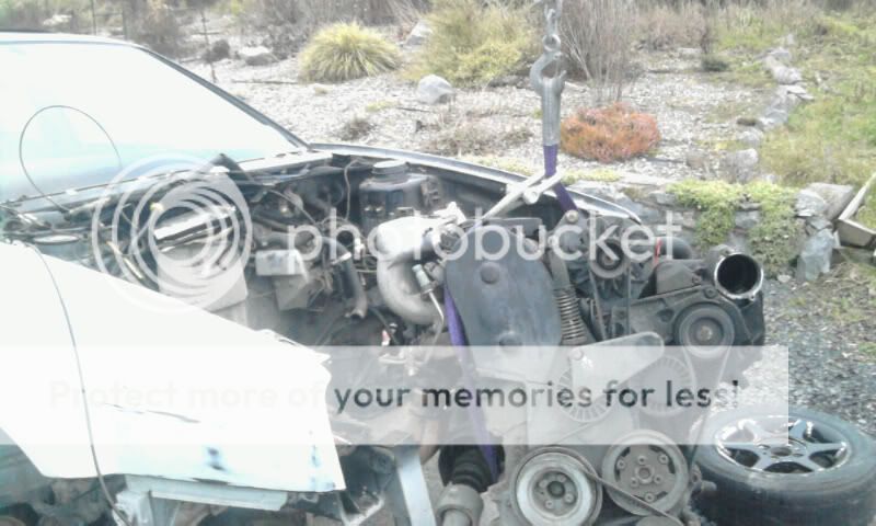

Haven't updated this in a while have been busy.
Engine's out, just have to tidy up the loom, out with dash and remaining interior and remove the brake master cylinder on the bulk head as well as line's etc so the full engine bay can be sprayed. Off for paint in 2 weeks. Macadamia brown outside, Champagne/gold colour inside still undecided on colour though.
Had planned on flushing engine bay and tidying it up but seeing as the G60 looks a fairly messy engine when sitting in a bay there's no point, also there'll be intercooler piping that'll have to be re-routed as well as cold air feed, coolers, fuel pressure regulator etc etc.
Picked up a thermostatic oil cooler thanks to Richie (RG16VT) and hoses to re-route the water back into the block rather than using the water cooled oil filter thanks to Daveslp.
MASSIVE thanks to Dave also for the very generous lend of his engine crane, much appreciated dude!

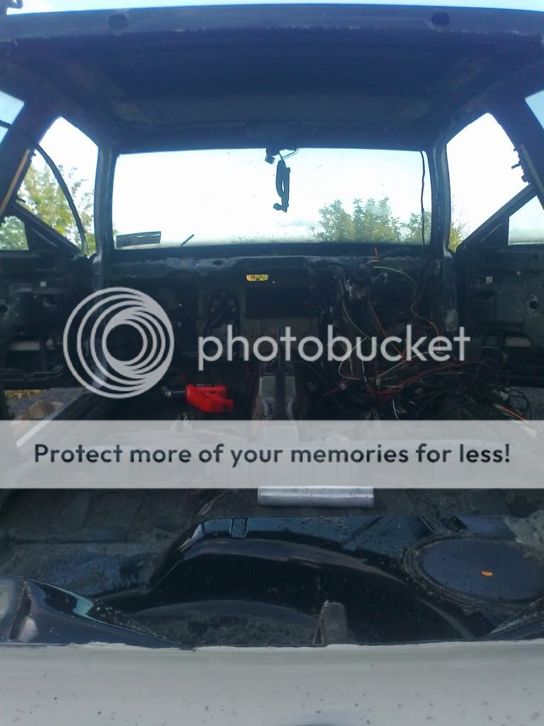

After yesterday at Dubshed I have made up my mind that although I hope my Corrado will be finished to a decent standard, hopefully have nice fitting wheels and sit nice etc, I will use it on trackday's more rather than show and shine events. It would absolutely drive me nuts if I had to park it up after every show for fear of scratching the paint. So I hope to enjoy this car to it's full extent when money allows on track aswell as NCTing it for the odd road trip to some events.
So interior is now fully stripped of nearly everything, dash, heater matrix etc. Just have to take out the remainder of the interior loom. All sound deadening is being chucked out as it's rather heavy (have about 20kgs removed). I hope to however get some new heat and soundproof for firewall for behind the dash.
All brackets and clips have been removed from the bay in order to get it ready for paint, jut left to degrease it and remove the remainder of the seam sealer.
Main thing i'm focusing on now is saving up for the respray for engine bay, jam's and full exterior. In the meantime I will underseal or paint the car underneath and give the full interior a lick of paint seeing as there is no interior going back in.
Just a bare shell now with windows, more work this weekend and will get up to date pictures soon also. Lots of work ahead

Only picture's I have, excuse the poor pics they were taken from my phone.
Only getting to work on this every odd weekend as the car is in Limerick and I live in Dublin now for work. I have been in and around the car about a million times and I have not found 1 spec of rust, only minimal surface bits on rad panel and subframes etc, it's mind boggling!
