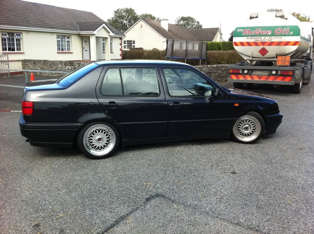

Anyone can buy a mint car and fit fancy wheels. So I bought this,one to actually see what's involved in car repair,and two to have a truly one off mint car. Some my recognise this from the money pit project on here. It's in need of a lot of work,new sills both sides,arch work,roof rain gutter both sides,new booth lid. Car is in with Davy Pickard (davyp) Waterford at mo so that should keep him busy for a bit.

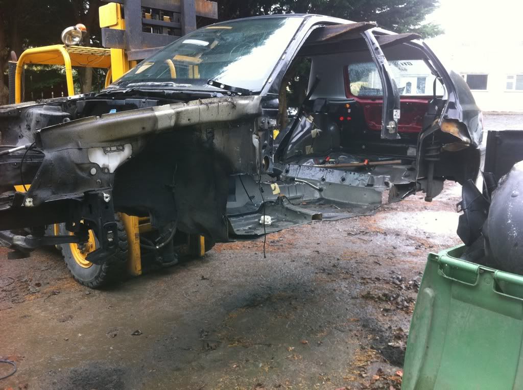

Got a doner golf shell from neilc for parts (thanks again)was a French import no rust this is it now

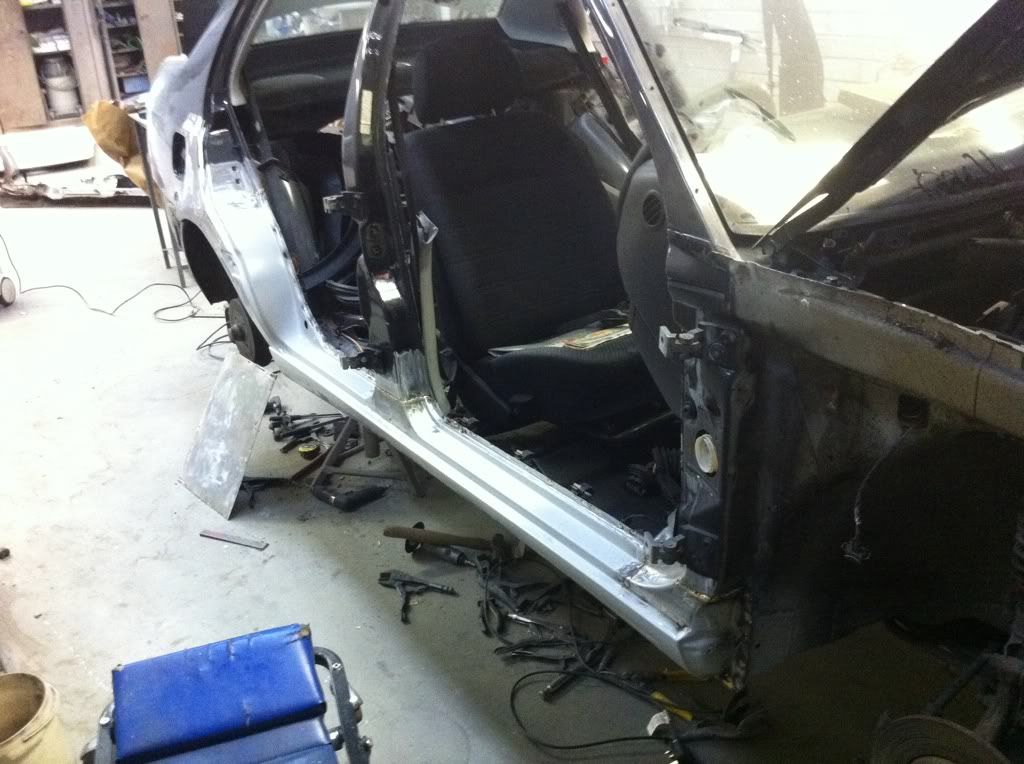

And this is as far as Davy's got on the Vento.

Well there's a hole I could put a box of matches through in the rain gutter where the front roof bar would fit,and arches were bad in usuall places with patches and holes between so better to do it right and replace. Bubble under licence plate on boot. So got a clean one from breakers €20.

It was bad When some one had repaired a hole in the roof under the roof gutter with a rubber patch
and polish don't fix rusty holes in sills
